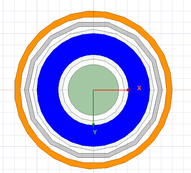

January 28, 2025 at 10:47 pm
J.MURPHY104
SubscriberHi Gluo,
The Trans Band is correctly defined and I have adjusted the air gap and that didn't help/make any difference.
In the image below the Transient Band I have defined is only around the blue, the green circle is stationary, which I want it to be but it is still giving me the error. I have a current assigned to the orange circle on the outside but that has no connection to the Trans Band. Can you indicate any more possible things I can do?
Thank you!

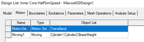

J.MURPHY104
SubscriberHi GLUO,
I do not understand what you mean by inner region and I do not understand its purpose. Can you please clarify or if anyone reading this understands, can you please help.
I appreciate the cross-sectional breakdown but I unfortunately do not understand that either. I can guarentee the stationary objects are not in contact with any objects in motion.Â
Let me know if this is correct but you are saying I need an inner region inside the motion band, both of which only surround the Ring part of the set up?
Thank you for the help so far. I really need this motion setup to work. I am looking forward to your reply.

January 29, 2025 at 4:04 am
GLUO
Ansys EmployeeHi,
I think the main issue is lacking of inner region. A conneted cylinder at the end might not be necessary. I cannot post picture due to some forum rules, so I will use M for motion band, R for the moving rings, I for inner region, and S for stationary region. After adding the inner band and cylinder, the cross section looks like this:
SÂ S S SÂ S SÂ S S S
S M M M M M M M S
S M M M M M M M S
S M M M S M M M S
S M III M S M III M S
S M IRI M S M IRI M S
S M M M S M M M S
Please make sure the objects in stationary not touching the motion band from outside,and the moving objects not touching the inner band from inside.
GL
January 29, 2025 at 2:49 pm
GLUO
Ansys EmployeeYes. Inner region is a band smaller than motion band but still contains all moving objects.
