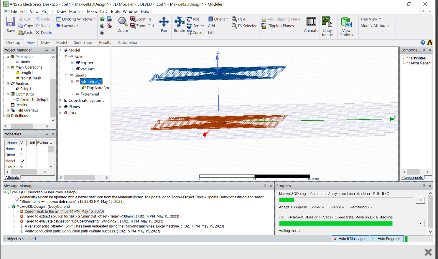

      im facing a problem in the simulation
      im designe a wiless power trasmiter coils and i have 2 eror
      the first one is

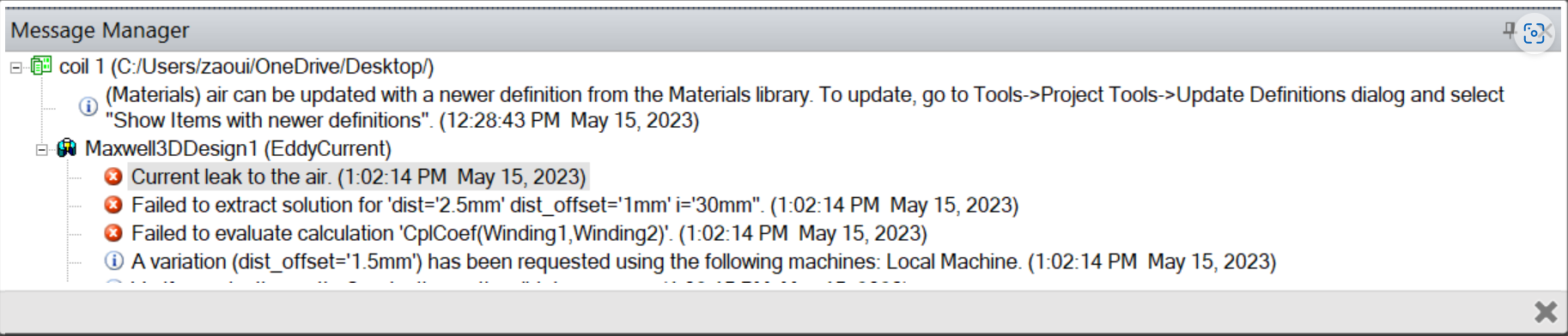

      Process '3dedy' terminated abnormally it may be out of memory or kiled by rhe user
      and the second one is down below
      pleas can you help me to fix this problem
    • Reshmi Raghavan
      Please find the reply below.
      • Process '3dedy' terminated abnormally it may be out of memory or kiled by rhe user
        • Please check the RAM utilization during the simulaiton, the error can come up if the memory usage is on a high.
      • Current leak to the air
        • please check if there is any intersection within the conduction path.
        • non model one of the coil and do the simulation considering other paths to first identify which part is creating the issue, then check the gemetry of the identified part
