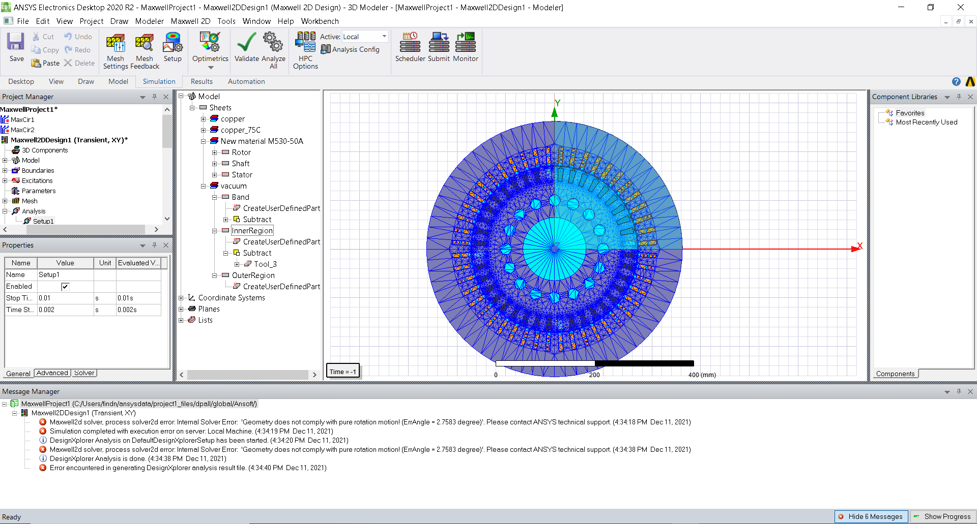

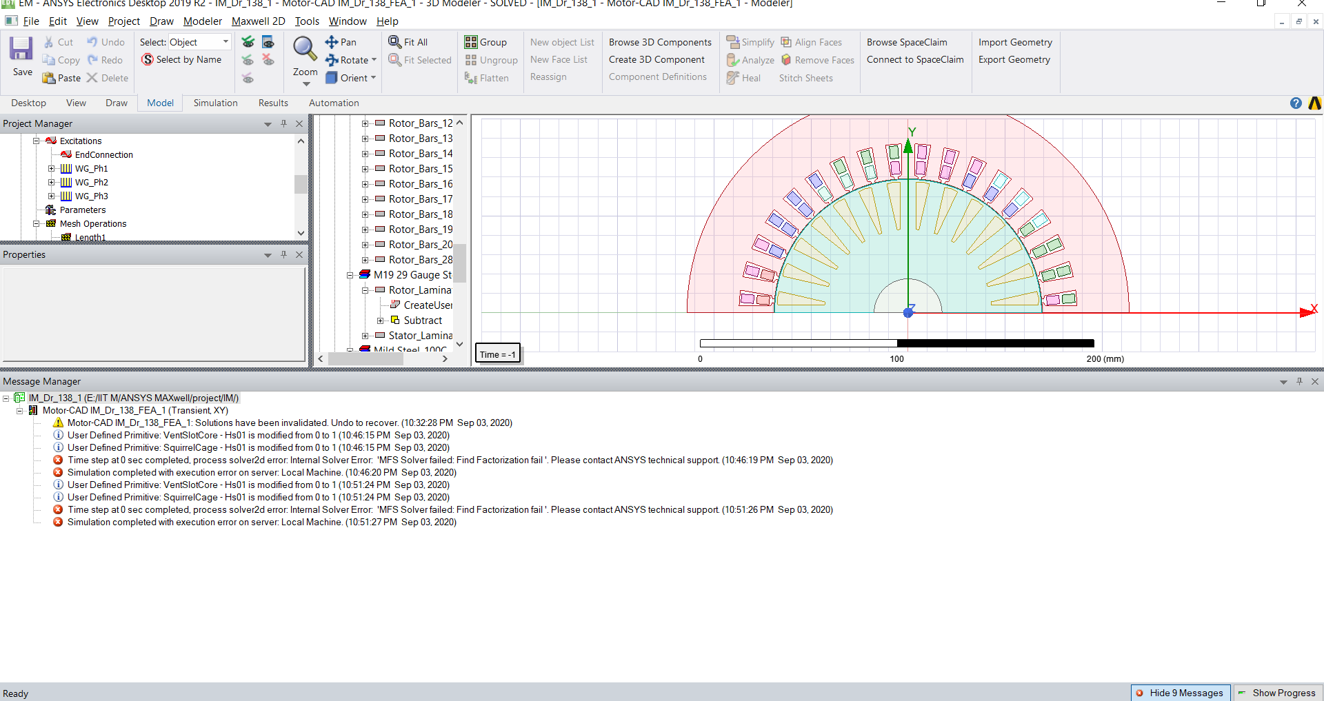

It looks like some objects in geometry are intersecting.
Check for any interference.
Check for proper Band definition for all the rotating objects in the geometry.
Define band by drawing a polygon with multiple segments and also an additional dummy object (polygon) between rotor and band for better meshing.

Subscriber.try with bigger mesh elements. it worked for me.
