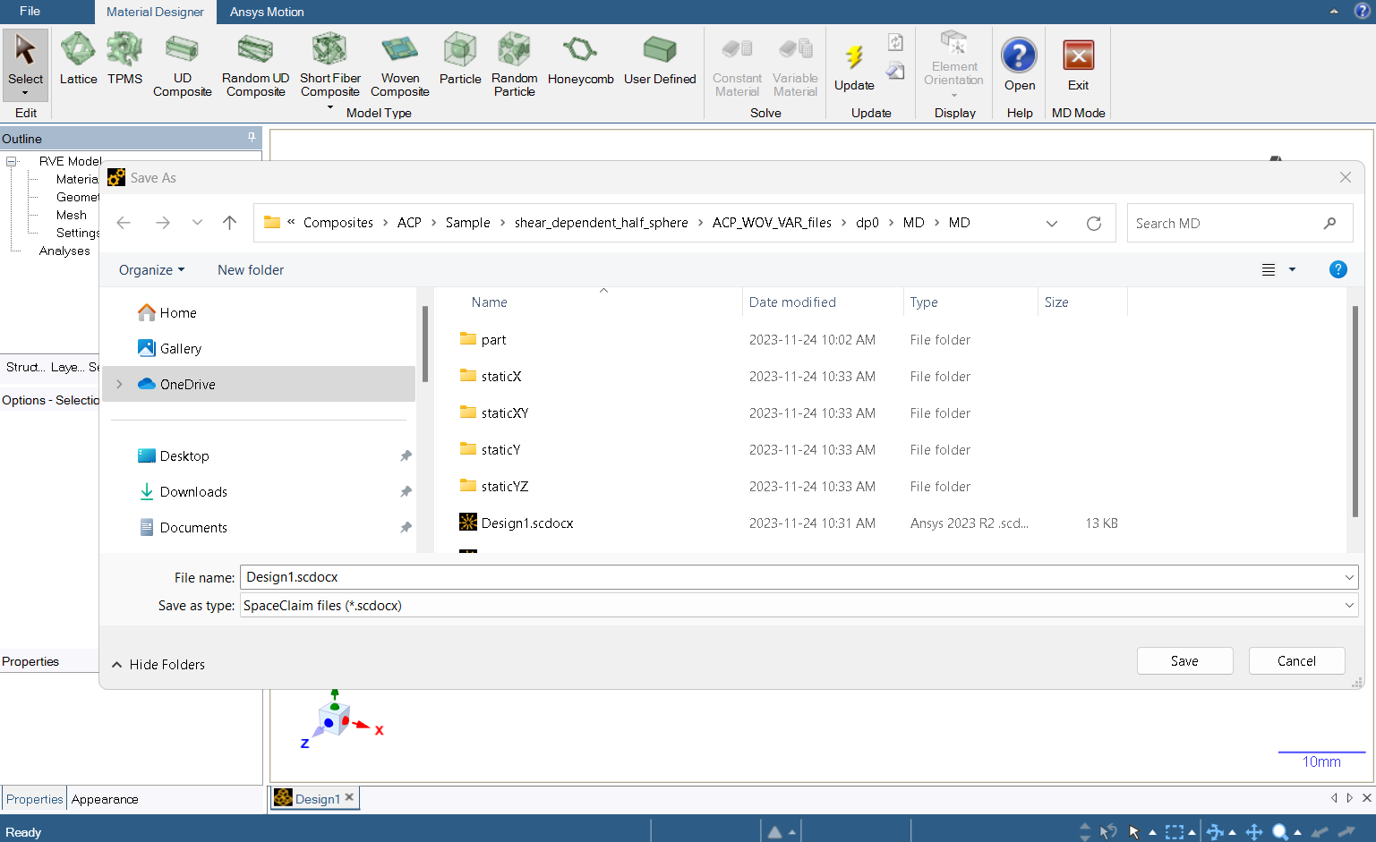

I was using the module perfectly before; however, later on, when try to open the MD, it goes to save as mode. I tried different scenarios to solve it. Including setting everything to default, cleaning the %appdata%, resetting the PC, Also installing the older version 2022R2. But still the same issue. Continuing with saving as "Design1 or MD.scdocx" and defining the model also does not work. It loses the files during the updating of the workbench and comes to error then. Attached is a photo of that.

What happens if you try to open something saved locally instead of using Onedrive?
Also, if open Workbench by right-clicking on The Workbench Shortcut in the Windows
Men and choose: More->run as administrator -

I tried many ways, including using admin grants. But it was not working. I had to fully uninstal and reinstall the software to have it resolved.
