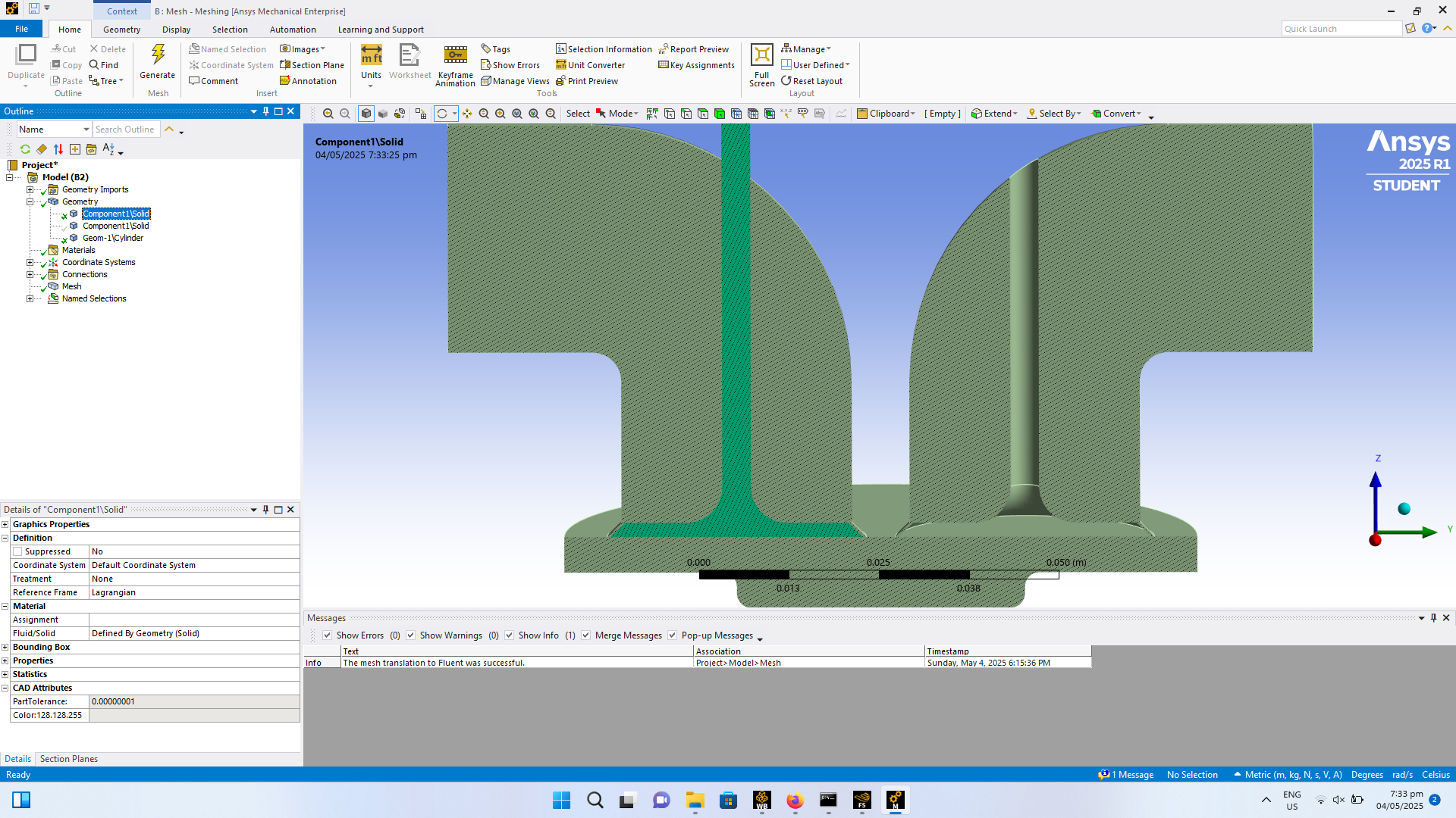

SubscriberNew to this and learning reduced errors but still have this problem while setting valve inputs. A spark ingnition two valve enigne. Probably other errors too, there is a gap in the CAD model between the valve seat and the valve face of 0.5 mm. In the inputs IÂ Â Exceeded limit of 500 iterations, please check boundary condition settings.
Ignoring update of min_lift because it is currently a Workbench parameter.
It must only be updated from Workbench. Â

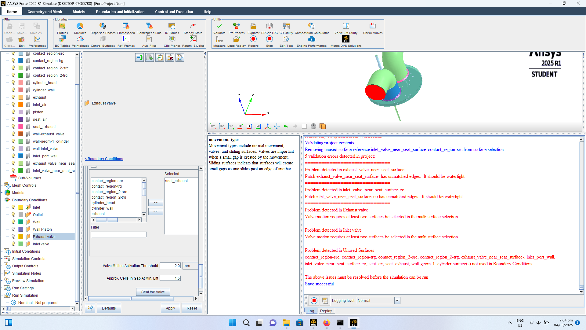

SubscriberEverytime I enter seat_exhaust and Exhaust_valve_near_seat_surface in the bottom left seletion, the latter disappears once I select Apply and then save, as shown above.Â
