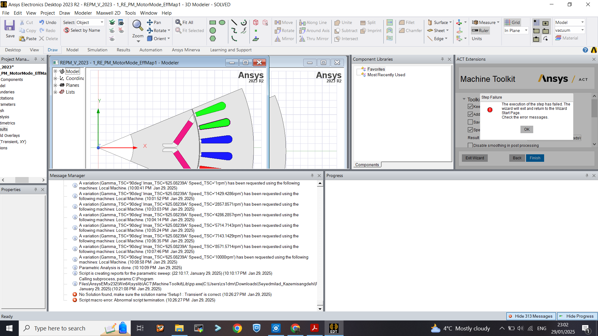

      Case study: IM design used to compute the efficiency map using the Electric Machine Toolkit through ACT..
      I set the parameters and run the simulation (exact set-up & parameters in the doc link below).
      The simulation takes about 4 years on a laptop, shows a message that the sweep parametric analysis is done.
      Then, the software should automatically plot a few graphs including the efficiency map. That is where I get error messages. The error is attached. It says no solution found and Abnormal script termination (see screenshot).
      Any advice on how to fix this issue please?
      Thank you.

      Looks like this error message is pointing to the setup1, do you get the same error message if just run Analyze (without ACT)?

        When I just run 'Analyse All' without invoking the Machine Toolkit I get a successful run....no errors (see screenshot). It's a vexing issue.

          Hi Des, thanks for trying it. Looks like the issue is relating with Machine ToolkitACT. Please follow the steps from Maxwell manual, start from less parametric sweep and see if it will run. Then move on to the full parametrics.
        • des.ryan
          Thank you. Unfortunately that is unlikley to point to the error. I have successfully run one of the shipped examples (parametric sweep using the machine toolkit) and this works correctly.
