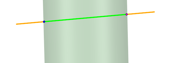

      An approach would be to defined your plate in SpaceClaim with a given thickness (at least the size of a mesh elements). Then, you can add a series of disks (right click in the geometry section to add them) which will introduce the drag. Make sure you keep your added mass very small so you don’t count it twice.
      Alternatively, you could create a wide, thin rectangular cross section line body. This introduces the mass, added mass and drag for the heave plate, and graphically looks like it should, as long as the heave plate is rectangular.

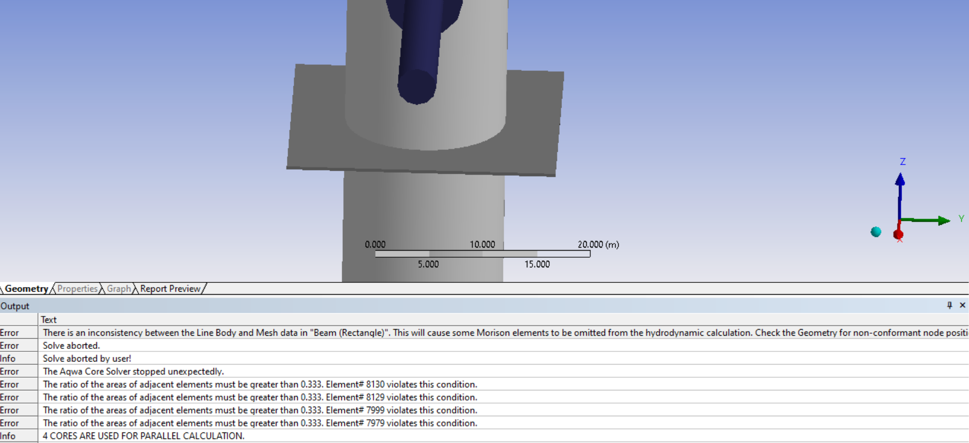

      I tried all the ways of making it.I tried the way to create a wide rectangular cross section body.But the line body needs to get through the main body and errors appear again like those below.I want a plate to SURROUND the cylinder body,so i could only make line bodies inside the main body too.
      So,errors appear and i can do nothing:
      1)I tried to draw at spaceclaim ,but i had errors again 1.000element violates the condition(smaller thickness of the plate than the element size,almost half of it).I also insert heave disks and i made point masses for them,but i …i want some thickness .My favourite way would be adding a rectangular plate(as it cant happen for a circular plate) via line bodies,but it didnt work.Any idea or help for it???
      2)When we insert heave disks…and we add point mass(element) for them(aqwa reference p.70 says about that) ,do we have to insert the moment for inertia for a disk or for a circular ring(the diameter of the heave plate bigger than that of the cylinder)?And when we insert series of them trying to give thickness,what distance should they be for having better results(0.1 or less?) and should they have the same drag coefficient or only the top and bottom disks have?
      Thank you a lot!!!
    • Ingrid M
      Good morning,
      1) the thickness of the plate should at least be the size of an element for the meshing to happen correctly.
      2) you will need to add a point mass & moment of inertia to account for the mass properties of what would be the plate. Then the hydrodynamic properties (drag, added mass) would be modelled through your various Morison elements so there is no need to set a thickness value for them. You ring can be modelled with overlapping discs. You would need to ensure is that the sum of the discs area is equal to the real world area of the skirt.
      I guess you don't need to implement both solutions: it could be one or the other.
      I hope this helps.
      Kind regards,
      Ingrid
