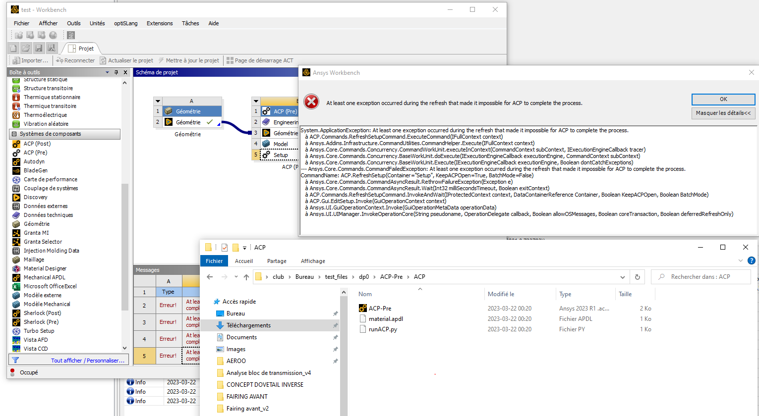

I am having a problem opening Ansys ACP, I get the following message :Â
ACP: 5 errors while refreshing file C:\Users\club\Documents\Analyse composite\Carrosserie\FAIRING AVANT\FAIRING AVANT_files\dp0\ACP-Pre\ACP\ACP-Pre.acph5. The first errors are (a maximum of 5 shown):Â
The log file is below :Â

2023-03-04 11:58:55.027148 error: ACP: 5 errors while refreshing file C:\Users\club\Documents\Analyse composite\Carrosserie\FAIRING AVANT\FAIRING AVANT_files\dp0\ACP-Pre\ACP\ACP-Pre.acph5. The first errors are (a maximum of 5 shown):ÂExecution of line 2 failed:
db.import_model(name=u'ACP Model', path='C:\\Users\\club\\Documents\\Analyse composite\\Carrosserie\\FAIRING AVANT\\FAIRING AVANT_files\\dp0\\ACP-Pre\\MECH\\ACP-Pre.h5', format='ansys:h5', ignored_entities=['materials'], convert_section_data=False, unit_system_type=None)
Error:'utf-8' codec can't decode byte 0xe8 in position 4: invalid continuation byteExecution of line 3 failed:

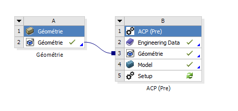

Can you create a simple surface (a square surface) in SpaceClaim and then, create a mesh in Mechanical and try to open the simple square surface in ACP? If you cannot do this, then there is a problem with your software setup. If you can do this, then the problem may be your geometry.Â
Have you also tried to open your geometry in SpaceClaim to convert it to SpaceClaim file format before going to Mechanical for meshing?

I created a simple square surface in SpaceClaim, created a mesh and tried to open in ACP, but the same problem occur. I also tried to opening my initial geometry SpaceClaim and the problem still occured. What could be wrong in my software setup? Just a reminder, if I open an old project and just replace the geometry with the one I am having trouble, then it works.
Looking foward to your response

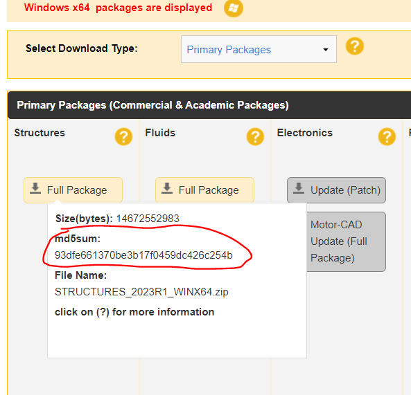

I downloaded the three ISO files from the portal for the installation of the software. I will try with the "Primary Packages" option instead.
Olivier

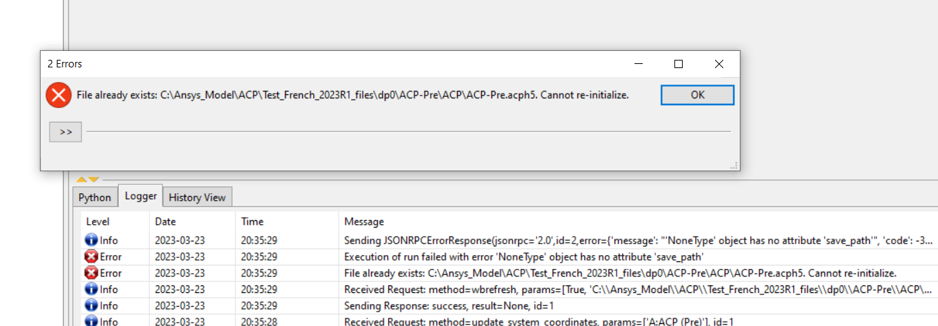

Reno Genest
Ansys EmployeeHello Olivier,
You should not have cleared the files in dp0/ACP-Pre.. Now the project seems corrupted. I meant to clear the files in the Appdata\Local\Temp.Â
Now try the following:
- On the WB project page right click on the ACP Setup branch (branch 5) and choose "reset".
- Try opening ACP again.
Reno.

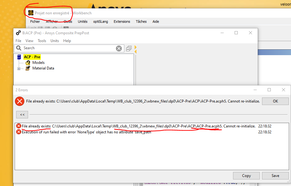

March 22, 2023 at 4:57 am
Reno Genest
If the above does not work, start over:
- Open a new WB project.
- Save the project on your desktop.
- Put an ACP-Pre system on the project schematic.
- Create a square surface in SpaceClaim. Make sure it is a surface and not a solid.Â
- Mesh the surface with shell elements in Mechanical.
- Open ACP.
Reno.

Véloom ÉTS
SubscriberThanks a lot for your help Reno, I have changed the language to english and it works, finally :)

Reno Genest
I am glad it now works for you! I filed a bug for this; hopefully it will get resolved in the next release.

Reno Genest
Ansys EmployeeHello Olivier, This is a know limitation that ACP does not support unicode characters. For example, "système de cordonnées global". The developers are working on it. Now, even if you rename the "système de cordonnées global" to something like "coordinate system", ACP will still not open properly. This bug has been fixed at 2023R2.

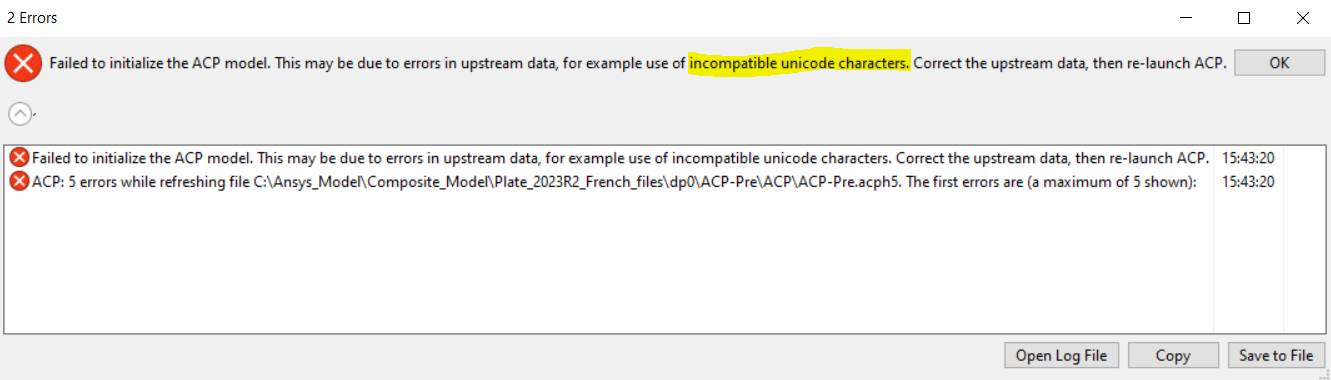

May 10, 2023 at 10:51 pm
Reno Genest
Some improvements have been made. Here is the reply from the developer:
"The support of unicode characters is still missing but we improved the error message (see screen shot) and that the project does not get corrupt if the user initialized an ACP model with unicode characthers such as é, ö etc. "
Support for unicode characters is in the plan for ACP. Hopefully the developers can implement it soon.
