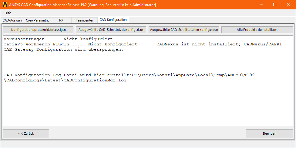

      For a student project I need the associative CAD-Interface for CATIA V5, but the CADNexus / Capri CAE Gateway can't be configuered because the installation files for it are missing (states the CAD Configuration Manager, see image below, translation at the end of the text).
      My university offers two academic teaching license (2019R1 and 19.2; not the student-edition), which - at least I thougt so - should contain the license for the associative CAD-Interfaces for CATIA, Creo etc.. At our simulation lab we have 2020 R3 Research (I think), but the CAD-Interfaces also can't be configuered - except the one for Creo Parametric.
      Since my CAD-Part is designed with a lot parameters created by a CATIA-Macro, which need to be optimized by ANSYS, I see no other possibilities than the associative CAD-interfaces. Is there any way to get the missing installation files for the CADNexus CAPRI CAE Gateway from ANSYS?

      The CADNexus package is a separate download from the ANSYS Customer Portal.
      It is located under Add-On Packages.
      Make sure you pick the correct version at the top of the page before scrolling down.
      https://support.ansys.com/AnsysCustomerPortal/en_us
    • Sirk3D
      Thank's a lot, Geo, for your quick response! I thought I couldn't access the customer portal, because I couldn't get a customer number, but I managed to find the customer number and it worked.

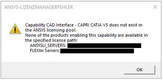

      I could download the installation files and successfully configure the interface with the CAD Config Manager. But when I started Mechanical in the Workbench the geometry couldn't be loaded, returning the following error message (I blacked out our license-servers adresses):
      I downloaded the correct versions for 2019 R1 and 19.2, both returning the same error. Is this error due to missing licenses of my institution for the CAD interface? Is there any way to get those missing licenses or did I configure something wrong?
