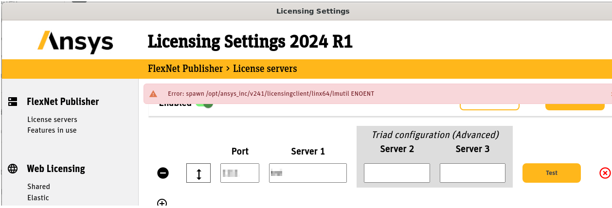

Ansys EmployeeHi Justin,
Please install 'lsb' (Linux Standard Base) package on Ubuntu.Â
