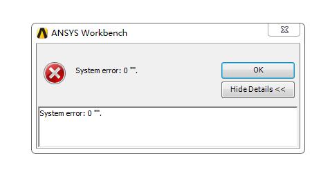

      Hi Everyone,
      I am neu to use ANSYS.After Installing Ansys Student and starting Workbench 19.2.It shows "System error: 0".
      can anybody help with this?  Thanks

      Hi invalidz,
      I'm guessing your username or computer name might have some non-english language or some special character
      Could you post the screenshot of the output of the 'set' command (without quote ' ') from the CMD Prompt ?

      Hi tsiriaks,
      This is the screenshot.my username or computer name are english language.

      Looks like installation issue. Can you uninstall and install again and check whether you are able to open workbench. Make sure you give the right license file.

      I have uninstall and install again.but it still has the same problem.

      Can you try with other username that's not 'Administrator' ?
      Also, try setting the default language of your computer to be English.
      https://www.windowscentral.com/how-properly-change-system-default-language-windows-10
      If these don't help, please follow this step
      in the Windows search (from taskbar), type
      %temp%.ansys
      then look for the file that says 'demo..log'
      Open this file up and scroll to the bottom of the file and post the screenshots of it. Essentially I would like to see the screenshot similar to what will4074 is posting here /forum/forums/topic/ansys-workbench-18-2-4/

      Hi tsiriaks,
      After I change the language to English,this problem is solved.

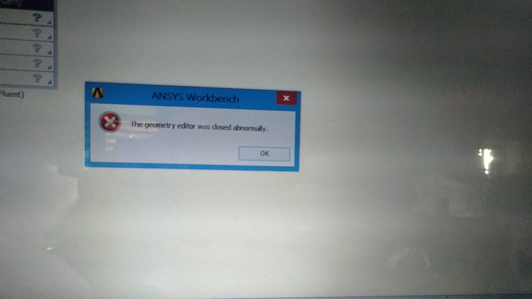

      i have installed Ansys 19.2 and during the  CFD simulation geometry editior is not able to load the design from space claim.same thing is happening in Ansys 19.1 also. i am using w10 64 bit Nvidia graphic card. plz help.
