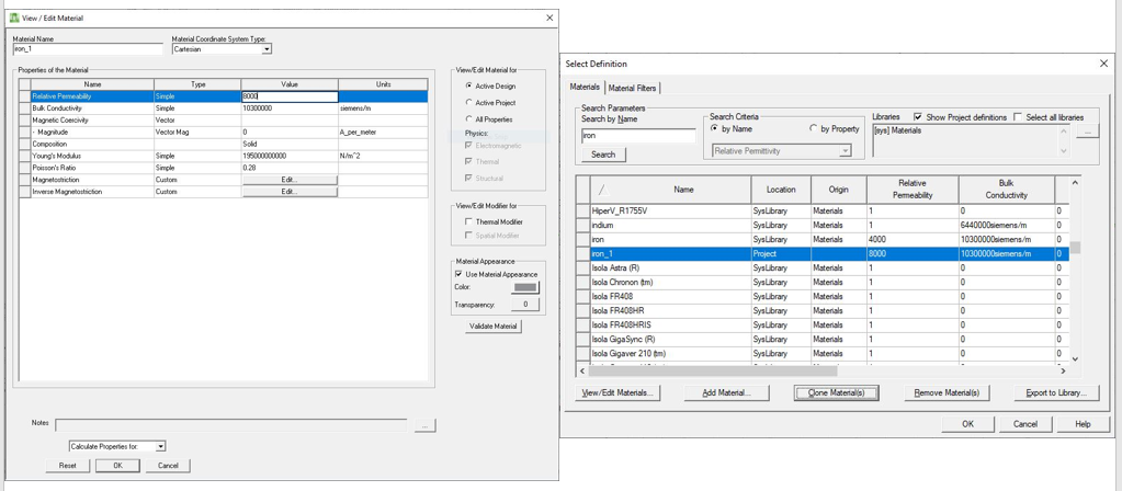

SubscriberI am using Ansys Maxwell to simulate a cylindrical iron-core coil; However, the relative permeability of the iron I am using is different from what has been initiated in Ansys.Â
I have changed this value View/Edit option, but the field value does not change.

SubscriberHello I am using Magnetostatic.
I need to change the permeability of Iron. Is it wrong to use the edit option?
Do I need to add material and copy-paste all the properties of iron?
Using edit bottom, I did design two separate models; however, the results did not change.
June 30, 2021 at 7:37 pmmbeliaev
Ansys Employeematerials are project properties, if you change in one design, it will be changed for another design as well
please do a test with cloned materials and let me know

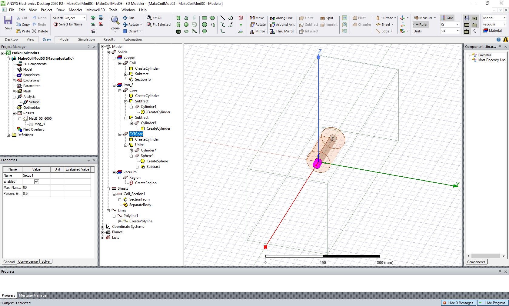

July 1, 2021 at 5:04 pmPKHeris

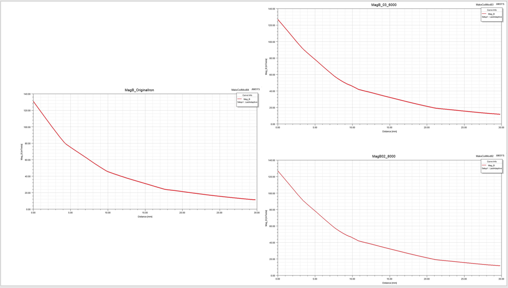

SubscriberI used cloned option, and I made three different models.
As you can see in the following image, for mu equal 6000 and 8000, the magnetic field shows the same value. Surprisingly, this value is slightly less than the case with the original iron from material library, mu = 4000).
One thing I noticed was that the Origin of material was blank when I cloned it. Would it be a problem?
July 2, 2021 at 10:39 ammbeliaev

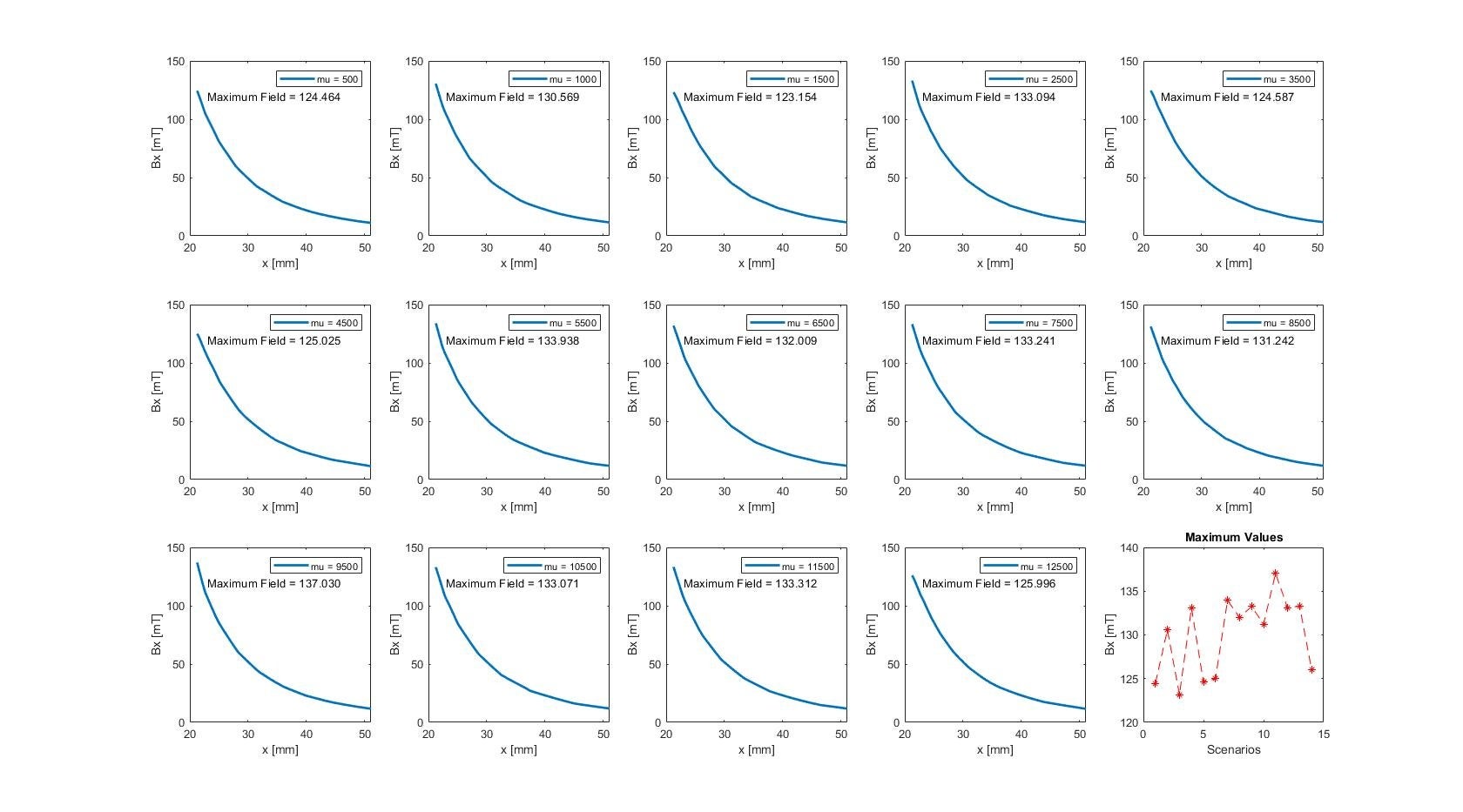

Ansys EmployeeI think in this case permeability is that high, that there is no difference in field. Almost no magnetic resistance
Try to do a test with MUr from 100 to 2000 every 100. You can do a sweep of the material and create a plot to compare
https://support.ansys.com/AnsysCustomerPortal/en_us/Knowledge+Resources/Solutions/Maxwell/2049128
September 12, 2021 at 8:06 pmSeptember 13, 2021 at 8:17 ammbeliaev
Ansys Employeecan you increase region size 3 times in +-Z and +-Y directions?
can you set energy error to be 0.2% or less in convergence criteria?
