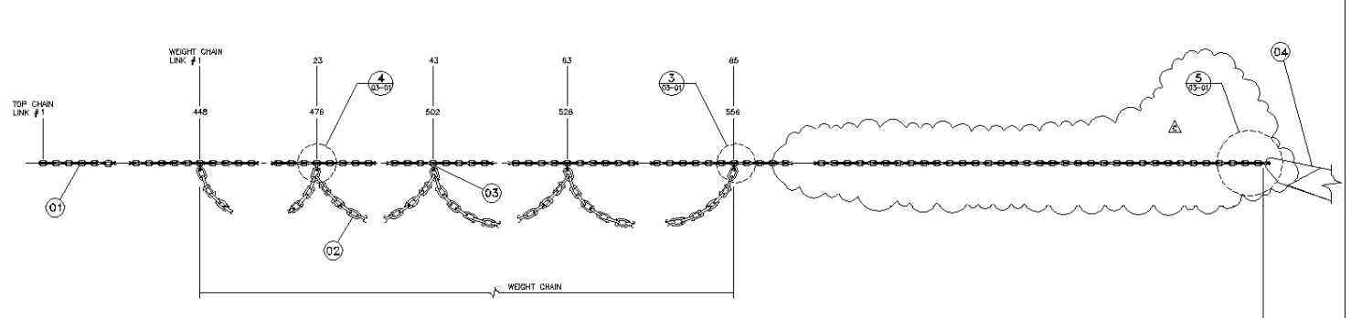

      I am working on a mooring analysis of FPSO. The attached image is the configuration of the mooring line. How can I define them?
      In another one, the mooring line sometimes goes through the existing structure on the seabed. So it requires attaching the buoy to the mooring line to avoid clashing. How can I define it in this case?
      Thank you very much for looking at it.
    • Shuangxing Du
      The catenary buoys can be defined between the nonlinear catenary cable sections.
      Could you please provide more detailed information of the mooring line? I cannot fully understand your image.
