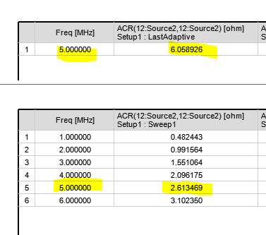

      I am using Q3D to simulate a planar spiral coil. When 5MHz is simulated separately, the ACR is about 6.05ohm, and when sweeping the frequency from 1MHz to 6MHz (Step=1MHz), the ACR is about 2.61ohm at 5MHz. I am confused why the values are different.
      Moreover, when sweeping the frequency, the software prompt 'Sweeps in lossless problems will have constant curve.'
      Thanks in advance!

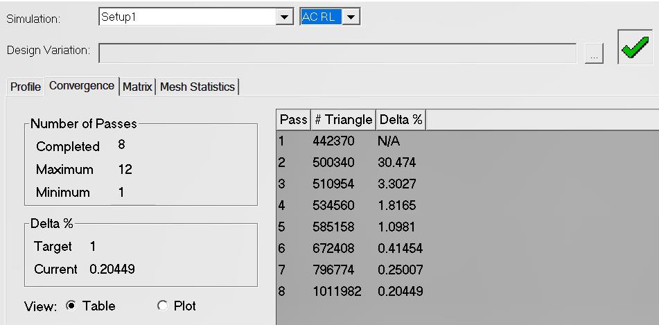

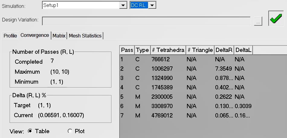

      Thanks for your reply. I used both the sweep method, and I got the same result.  I attached the screenshots to here.

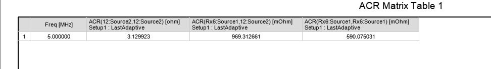

      Moreover, I changed the relative pemeability of copper from 0.999991 to 1, and then I changed it back to the original value(0.999991).  What's interesting is that in the same model the value of ACR has changed from 4.004ohm to 3.12ohm, and then no matter how many times I simulated, the value of ACR stays 3.12ohm.  Do you have any suggestions? Thanks again.

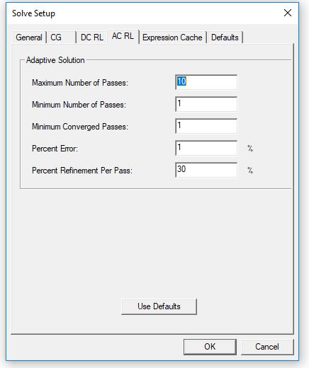

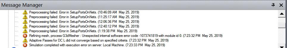

      What is your convergence criteria? Were there any warnings about your solutions not being converged?
    • Hanxue
      Yes, the software prompt 'Sweeps in lossless problems will have constant curve.'  The convergence criteria used is the system default.
    • TshawS
      is it somehow related to the minimum convergence passes?
