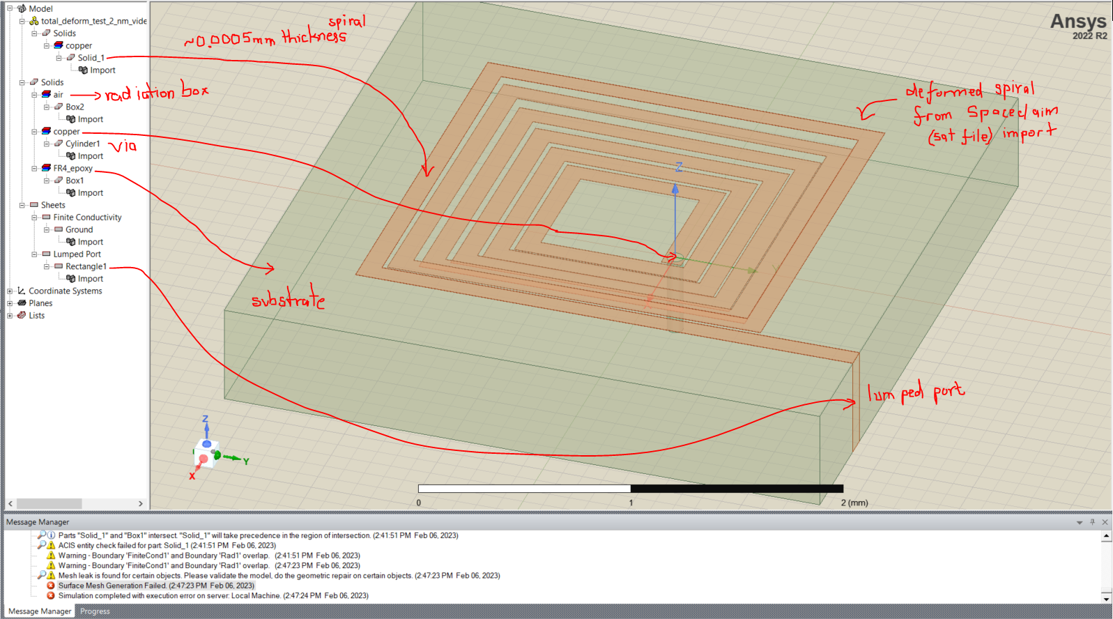

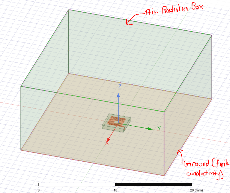

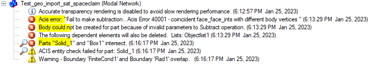

      I have this deformed spiral geometry which I imported into HFSS as .sat file. I created a substrate along with a via and lumped port to perform EM analysis. Before, that I tried to subtract the substrate from the spiral as it overlaps as shown in picture 2. Without subtracting, when I validate the design, it gives me errors as well.
      I would really appreciate your help with this.
      Picture 1:
      Picture 2:
      Errors:

      Did you uncheck "Set Material Override Tab" option in the desing settings? If not then there is no need to subtract the deformed spiral from the substrate.
      If you still want to subtract these two, then please send the screenshot of your model indicating the labels of every objects to help us serve you better.

    • Sneh Patel
      Hi Praneeth,
      Before under the "Set Material Override Tab" option in design settings, the option "Enable material override" was unchecked. So I checked that options and reran the simulation. It gave me a "Surface Mest Generation Failed Error". I have attached a few pictures to help you understand the model.

    • Praneeth
      Hi Sneh,
      I have noticed that you are using 0.0005mm thickness for the spiral conductor. If possible, I would recommend you define it as a sheet. This will simplify the geometry and the computation would be much faster. Also, this approach would not decrease the accuracy of the results.
      If the above approach is not possible, then try to assign mesh operation. More information about this can be found here - Ansys Electronics 2022 R2. Alternatively, you can go through "defining mesh operations" chapter in the HFSS help pdf document.
