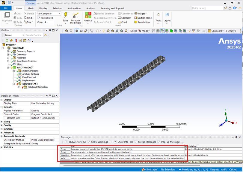

SubscriberI find a lot of posts about this error using the free student version, but here we have the academic/research licences and we still experience this error when trying to solve a dummy problem with LS-Dyna:
Our sales rep certifies that we are supposed to have access to that solver with our licences. Would you please tell us how to use this solver? -

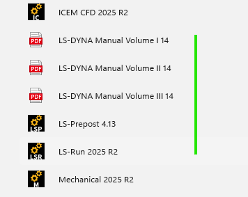

Seems you are using Enterprise PrePost very strange (this is commercial licence).Anyway to check for LS-DYna install like Nanda said (alternative):
You can also check that you have installed LS-DYna, by seeing if these are installed and visible as shown below (in 2025R2 start menu folder):

SubscriberHello Nanda,
Yes, indeed, LS-Dyna was not installed, when I looked in the folder that you mention.
It does work now after I checked it in the installer.
The confusion comes from Workbench having the LS-Dyna blocks available anyway.
