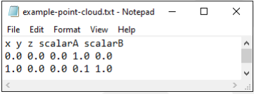

      Firstly, you need to create a .txt file with the values you want separating with spaces or commas. Just pay attention that the first row must contain x, y, z and at least one scalar variable (see the example below). The following row must contain the values for each point.

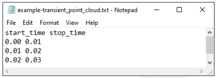

      Transient Point Clouds consist of sets of Static Point Clouds that are applied during the simulation following specific start and end times. In order to import a Transient Point Cloud, it is necessary to import a main text, csv or xlsx file containing the start and end times of each Static Point Cloud that will be then automatically imported to compose the Transient Point Cloud. If desired, an optional third column with the name of the files (with the file extension) for each start and stop time, as shown below:
