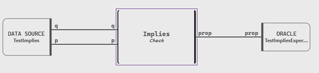

Using simulation data files
Another way to build a test harness is to read data from a simulation data file. Such a file contains the values of flows, as a list of values, and can be used as input for the operator under test (with a data source) or as a reference for checks (with an oracle).
For instance, let us consider the
Impliesoperator. The truth table of the operator defines the expected values for any input:$p$
$q$
$p \Rightarrow q$
truetruetruetruefalsefalsefalsetruetruefalsefalsetrueWe can easily create a simulation data file for the inputs, using the dedicated signal editor:
And similarly, another file for the expected output:
Finally, we create a test harness using a data source and an oracle, and connect them to an instance of the
Impliesoperator:It is also possible to use an oracle block but not check the inputs at all cycles. This is done by using a special Don’t care value (DC) for the flow in the simulation data file. If the expected value is DC, then no check is performed:
