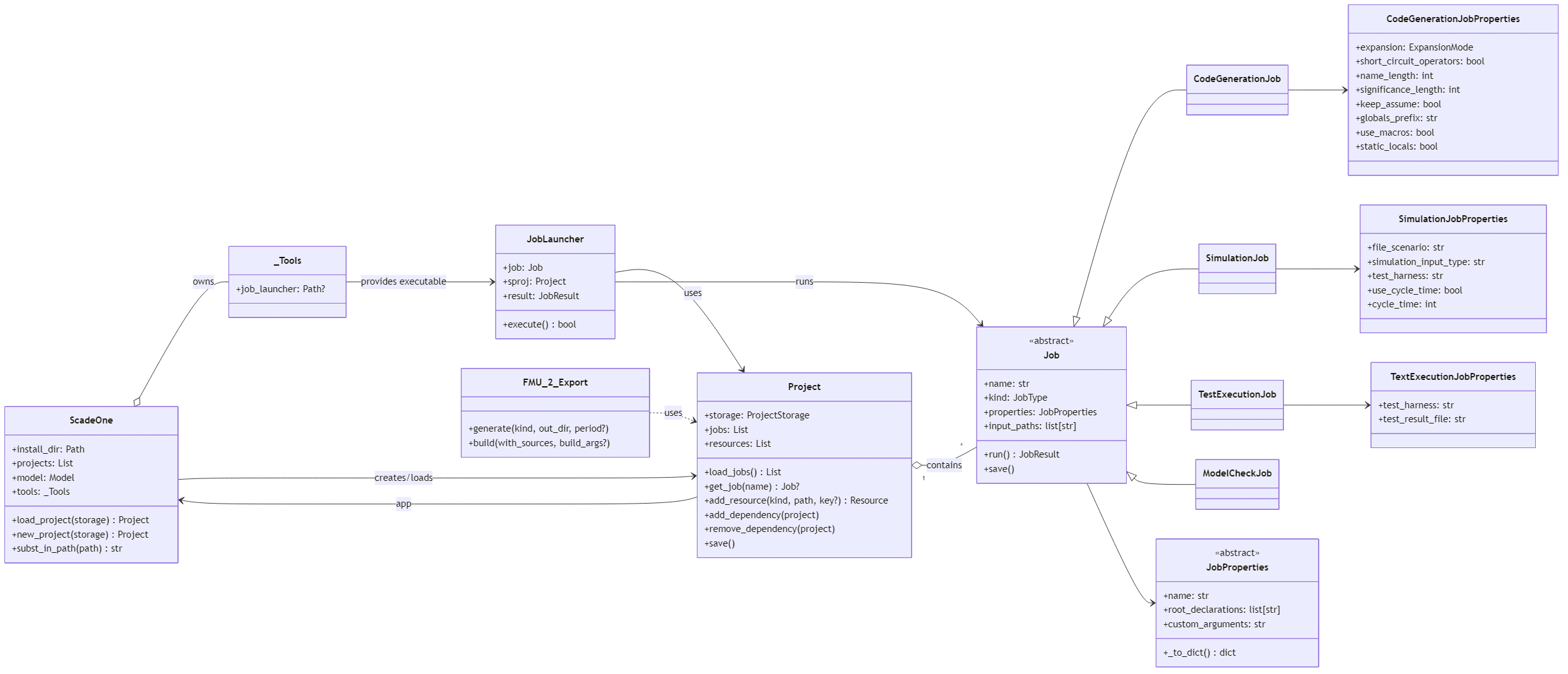

PyScadeOne Architecture Overview
First, let’s look at what we’re working with. The PyScadeOne package follows a clear, layered design:
Layer
Purpose
Key Classes
API Core
Entry point, access to tools and projects
Project Management
Handles .sproj content, modules, resources, and dependencies
Model
Contains Swan module and interface declarations
Job Execution
Defines jobs (.sjob), properties, and execution
Service Layer
Provides services such as FMU export, Python wrappers, and simulation data
Interfaces
Decouples mutual dependencies between core classes
IScadeOne, IProject
PyScadeOne overview (click to enlarge)Launching jobs with PyScadeOne
