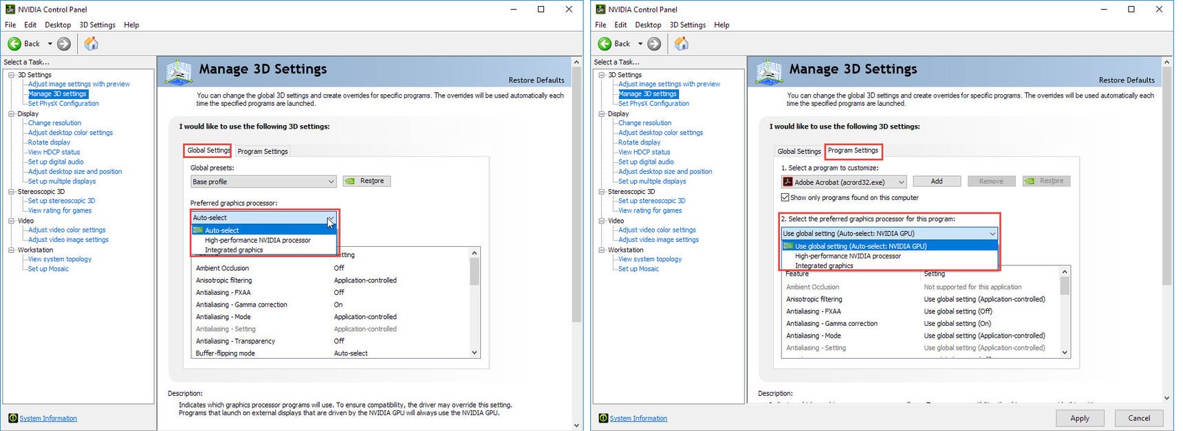

FAQParticipant1) To specify between NVIDIA and Integrated GPU
Go into the NVIDIA Control Panel (i.e. right click on your PC desktop, or through Windows search option).
Then go to “Manage 3D settings”
There will be 2 tabs, “Global settings” and “Program settings”
Go to “Program settings”, and if Discovery is not listed, Click Add.  If its not in that list, go to Browse and find the executable in your install directory.
The 2nd drop down should be a list of your cards, choose the one and click Apply.

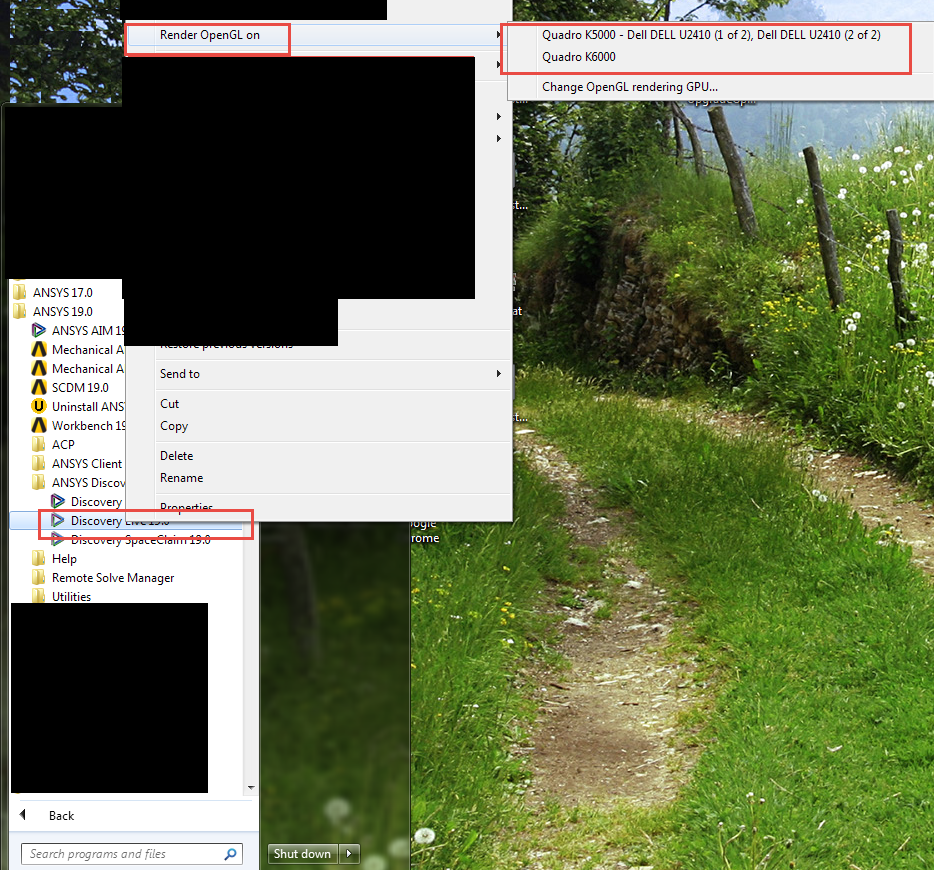

2) To Distinguish between multiple NVIDIA GPUs
Right Click on the Discovery shortcut, go to Render OpenGL onand pick the card you want to use for the solver
