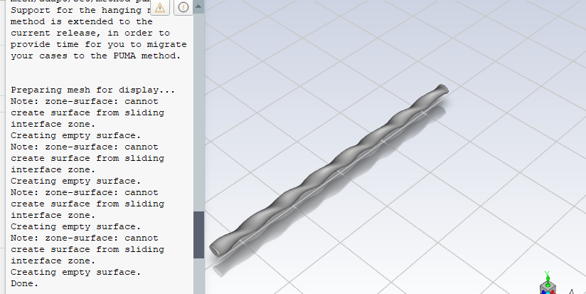

Subscriberits a simple hollow twisted pipe having fluid domain inside. this is showing below error.....in my another design(flow inside tube) also same issue.... i used boolean substract in between solid pipe and fluid domain but still showing this.... what can i do to fix this?????????Â
Note: zone-surface: cannot create surface from sliding interface zone.
Creating empty surface.
November 3, 2022 at 12:07 pm
Rob
Forum ModeratorThe warning is simply telling you the solver can't display the walls that are created as part of a non-conformal interface. Is there a reason you shouldn't have non-conformal interface zones?Â

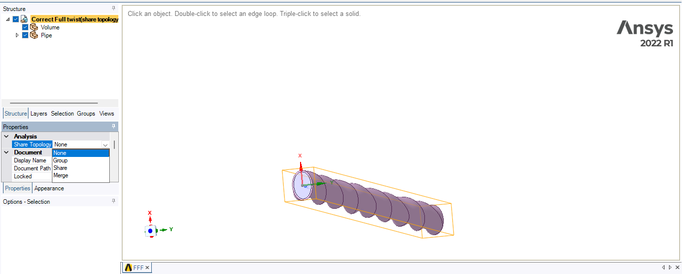

Forum ModeratorAh, the old options. Merge or Group ought to work, but if you update the software it's significantly better. Check options in the Workbench tab too: I nolonger have pre-2019Rx installed to check when the methods were updated.Â
November 4, 2022 at 9:33 am
Rizvi Arefin Rinik
Subscriberproblem solved as i used shear topology......but i dont undestand the reason .....in some cases using boolean substract this types of issue can be resolved...but this time it didnt work...any way thank you.....but using shear topology is there will any effect on solver?? as from fluid heat transfer will take place into the shell.

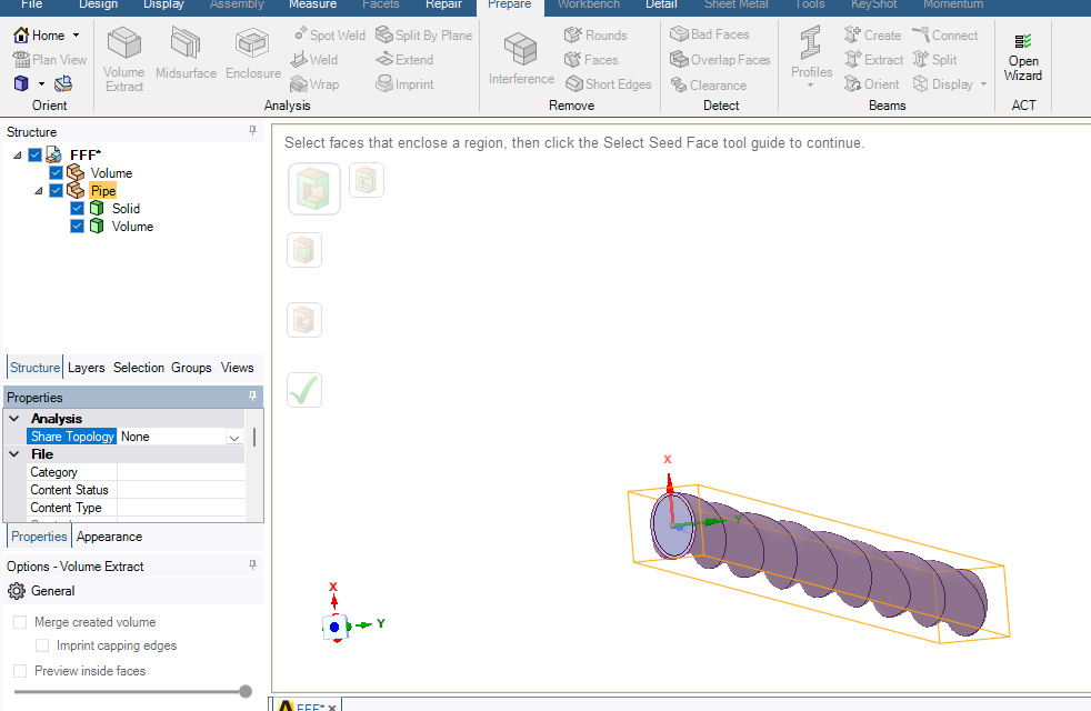

Subscriberas you can see 2 parts here so when its on file name it shows share and also in pipe it shows shear... but in volume it shows none....do i need to set all of them in share?
November 4, 2022 at 10:17 am
Rob
Forum ModeratorYou need to read the documentation. Share Topo is done just before transfer to meshing, and you need to use the options in the Workbench tab now you're in 22R1.Â
November 4, 2022 at 10:25 am
Rizvi Arefin Rinik
Subscriberyes i got you....thanks for the help.
