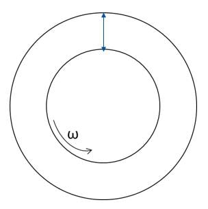

i have the following setup. I have two concentric cylinder, the inner one ist rotating with omega and the outer one is stationary.

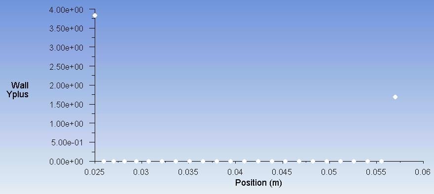

I'm using the k-epsilon realizable model with enhanced wall treatment. I'm not sure about the wall behaviour. Is the choice right? Near the roating wall, the normal y (mesh) is 1mm, near the stationary wall, the y ist 1.5 mm. For my simulation, i got the following results for y+. It is plotted in the middle of the length of the cylinders (along the arrows), from the top of the inner cylinder to the outer one.
So the main question is, do i have the right setup for the simulation in relation to the y+ value or on which aspect do i have to look at that it is right? I'm a little bit confused by the help, so it would be great if someone could explain it to me.Â

Ansys EmployeeIf you have enough points for the resolution of boundary layer than yes you have a quiet good start.
Optimal us if You can try reducing yplus to one and maintain a good boundary layer resolution.
I also recommend omega based models like SST but EWT is also okay for epsilon based approach. -

Ansys Employee1/you need either to estimate boundary layer size or do that after running the case by looking into viscosity ratio. As it is an annular gap I will recommend at least 20 points or cells across it.
2/better to place the first point inside viscous layer and use 10 to 20 cells across boundary layer of my you want to integrate all right to the wall. I do not recommend using wall functions here as might be the whole thing running at low or moderate Re number
3/SST is omega based model. It contains an automatic wall treatment.
Have a look in text books and visit our help. -

SubscriberOkay, so i have to do a finer mesh near the walls to get a smaller value for y+, right?
As i said, i"m using the k/epsilon model. I dont find the opportunity to turn wall functions off. Where can i do it?
June 27, 2019 at 8:04 am
Amine Ben Hadj Ali
Ansys EmployeeYou need to use the SST model as an option. You can still stick to your k-e model ans use EWF.
