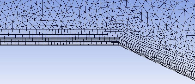

    • abd fs
      Dear kkande,
      At the wall I used inflation with 15 maximum layer. After using region adaptation I got to the curve above.
      model k-omega sst

    • DrAmine
      I cannot understand the issue? What is reader and document??
      Why are you not generating a pure hex mesh? Do not exaggerate with yplus keeping the boundary layer unresolved.
      And ensure deep convergence: check reports, imbalances and residuals.
      You have better results as in the articles if I judge it from the qualitative perspective.

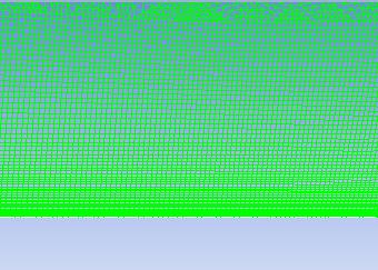

    • abd fs
      Dear AMINE,
      before the region adaptation I have 15 left
      after the region adaptation I have
      could you advice me please ?
      if you need info. please let me know
      Best regrds,
      Ser
    • Keyur Kanade
      As Amine has pointed out, please do mesh refinement in meshing rather than using adaption in Fluent.
      Also you may need to do mesh independent study by doing several iterations. You will need to create mesh witn 15 layers, 20 layers etc with different face/edge sizing.

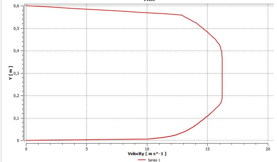

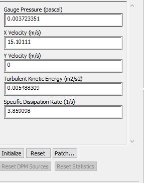

    • abd fs
      Dear kkanade,
      I did the refinement of mesh and I made the mesh sensitivity test but I always get the same results.
      could you take a look at  velocity profile vector before the ramp. after adaptation region
      here is the velocity profile that I inject into the domain inlet:
      Best regrds,
      Ser

      1-I created a triangular mesh throughout the area but I have refined the ramp area;
      2- I created inflation at the wall level with a well defined first layer thickness and with 15 layers.
      I hope I answered your questions
