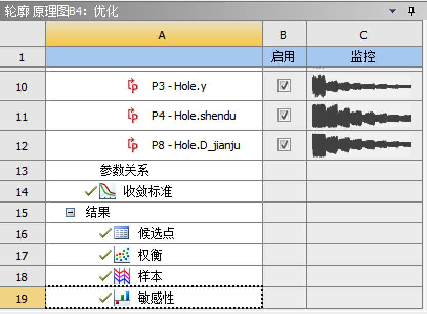

想问问大家响应面优化最后这个敏感性具体指的是什么
    • 1958017927

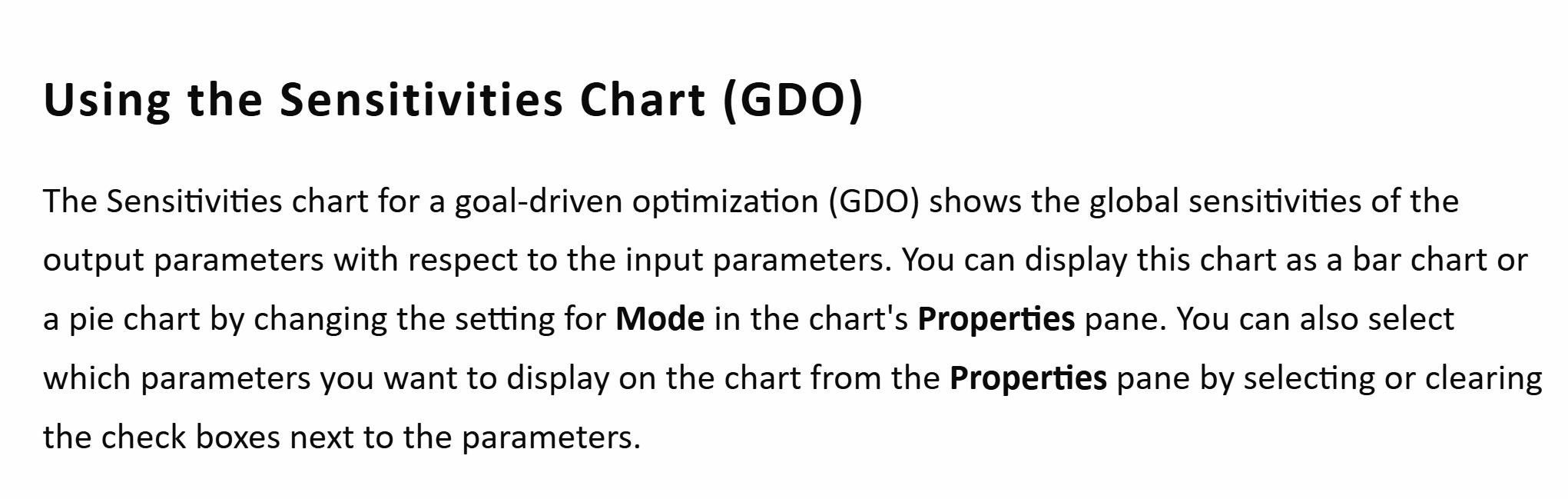

      这个是我在说明书里查到的解释,感觉不是很明白
      具体的问题其实是在ansys workbench响应面优化的这个界面中,当我更新某个输出参数设置目标为最大值和最小值时,得到的敏感性时不同的,想问问这里的敏感性指的具体是什么呢?
      希望大家可以帮助我解决问题,谢谢大家!
    • akhemka
      In response surface optimization, sensitivity refers to the degree to which a change in one input variable affects the output variable. It is a crucial aspect of RSM as it helps in understanding the interplay between factors and responses, which is essential for optimizing processes. Sensitivity analysis can be performed using various techniques, including design of experiments (DoE), Monte Carlo, and correlation methods. It allows practitioners to evaluate how model parameters influence the output or design requirements, providing insights into the most effective parameter combinations for achieving desired outcomes.
