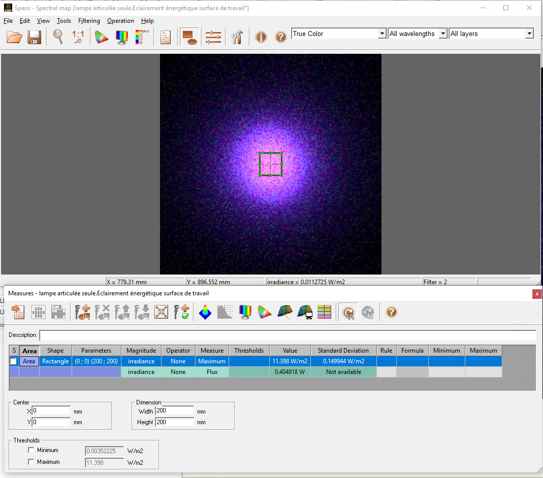

      I am currently working with the "virtual photometric lab".
      1) I get an energetic illumination that I want to convert into an exposure: I have to multiply each pixel of the map by a scalar (typically a time in seconds). Is this possible and how to do it?
      2) I want to compare this exposure to a reference exposure: use the "map comparison" or "map calculation" tools. How to create a map that corresponds to my reference exposure?
      In general, where can I find tutorials on how to use this tool?
      Thanks to you.
    • Fasehur Mohammed
      1. there's two ways to do this-
        1. use the rules in the measurement window- Operators and Functions for Global Rules (ansys.com)
        2. export a line of pixels to a excel sheet and then apply formula there. for this you can select a shape use 2d view section and then export as txt.
      2. Im not familiar how to do this. if its two maps then you can use map calc as a comparison. I will ask a colleague to respond on that.
