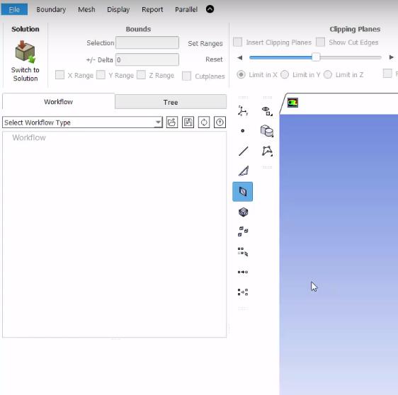

      Hi. I am a mechanical engineering student, for a few years I am using the software to learn. I noticed that in the version that I own (the students) I do not have active the "Wokflow" tab. Is there a way to activate it or is the version I have restricted in that aspect?

      Can you please insert some image of workflow tab you are talking about.
    • mach1991

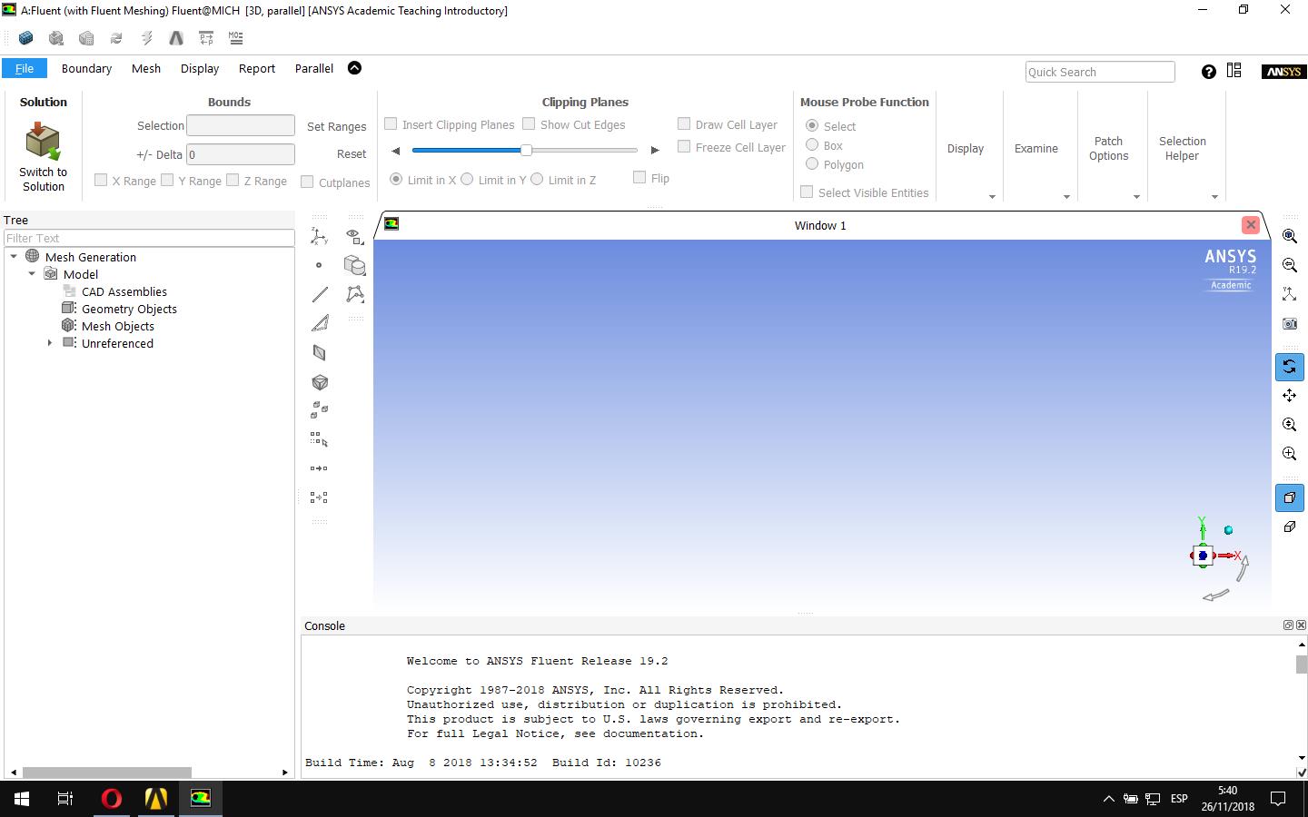

      Hi good day. I already have a version installed. First I attached an image where the tab to which I refer appears active, the second image is a screenshot of my computer.
    • Keyur Kanade
      It is for R19.2.
      If you using fluent meshing in workbench then is beta feature. Enable beta feature.
    • Keyur Kanade
      Workbench main page - tools- options - appearance - beta feature.
      Then open fluent meshing. If you still dont see it then in fluent meshing text user interface type beta y y

      Are you referring to the beta options in the workbench tools / options / apparence? Or they are beta options in Fluent. Could you explain how they are activated?
    • Keyur Kanade
      Workbench main page - tools- options - appearance - beta feature. Then open fluent meshing. If you still dont see it then in fluent meshing text user interface type beta y y

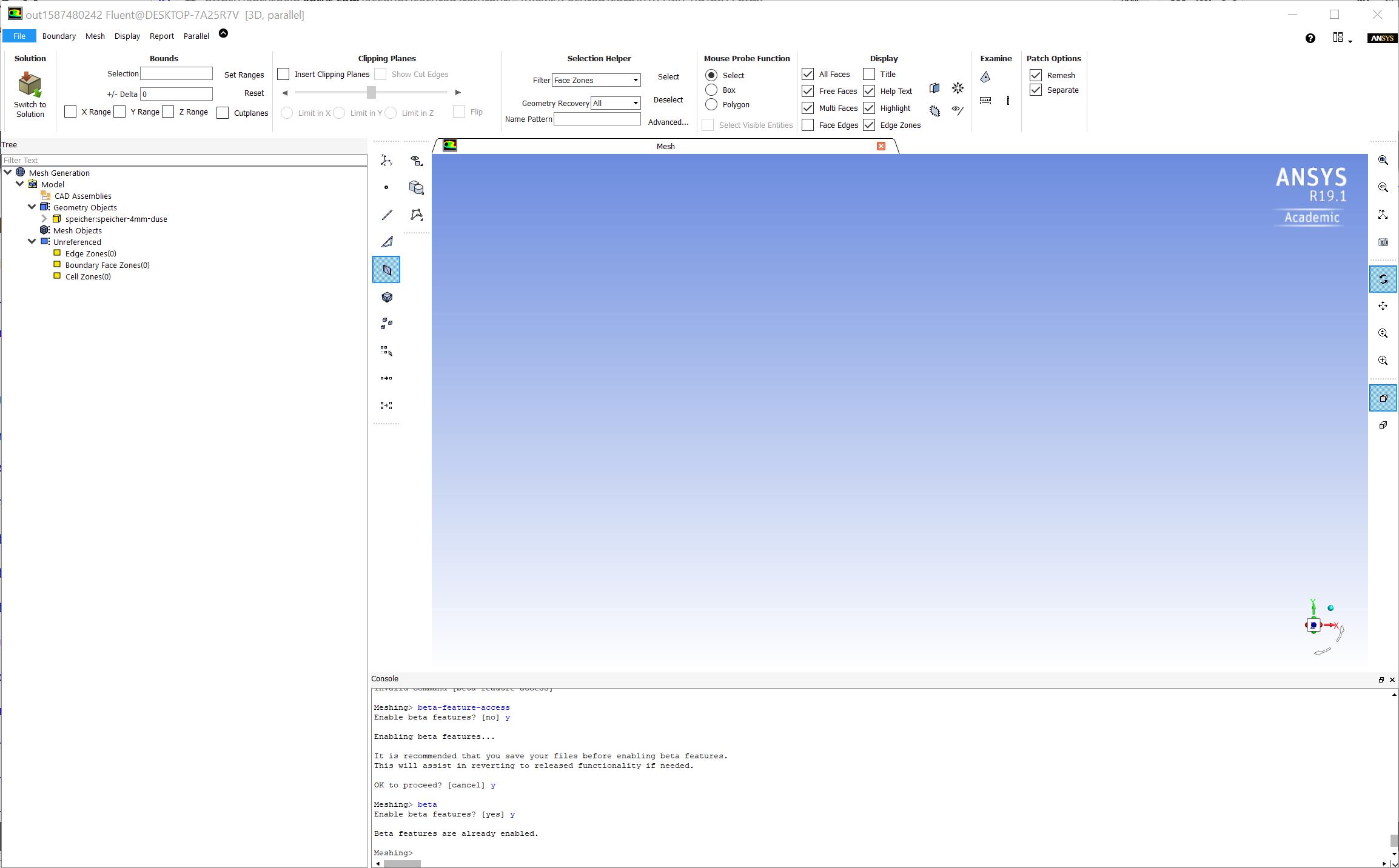

      Workbench main page - tools- options - appearance - beta feature. Then open fluent meshing. If you still dont see it then in fluent meshing text user interface type beta y y if it answers your question, mark this as Is Solution to help others on forum.
      It doesn't work by me. Does someone have another solution ?
      I need to use this version. A screenshot is as attachment
      Thank you,
      Deyan
      Have a look in the TUI menus, type the menu name in & press Enter, use q (Q) to move back up a level.
