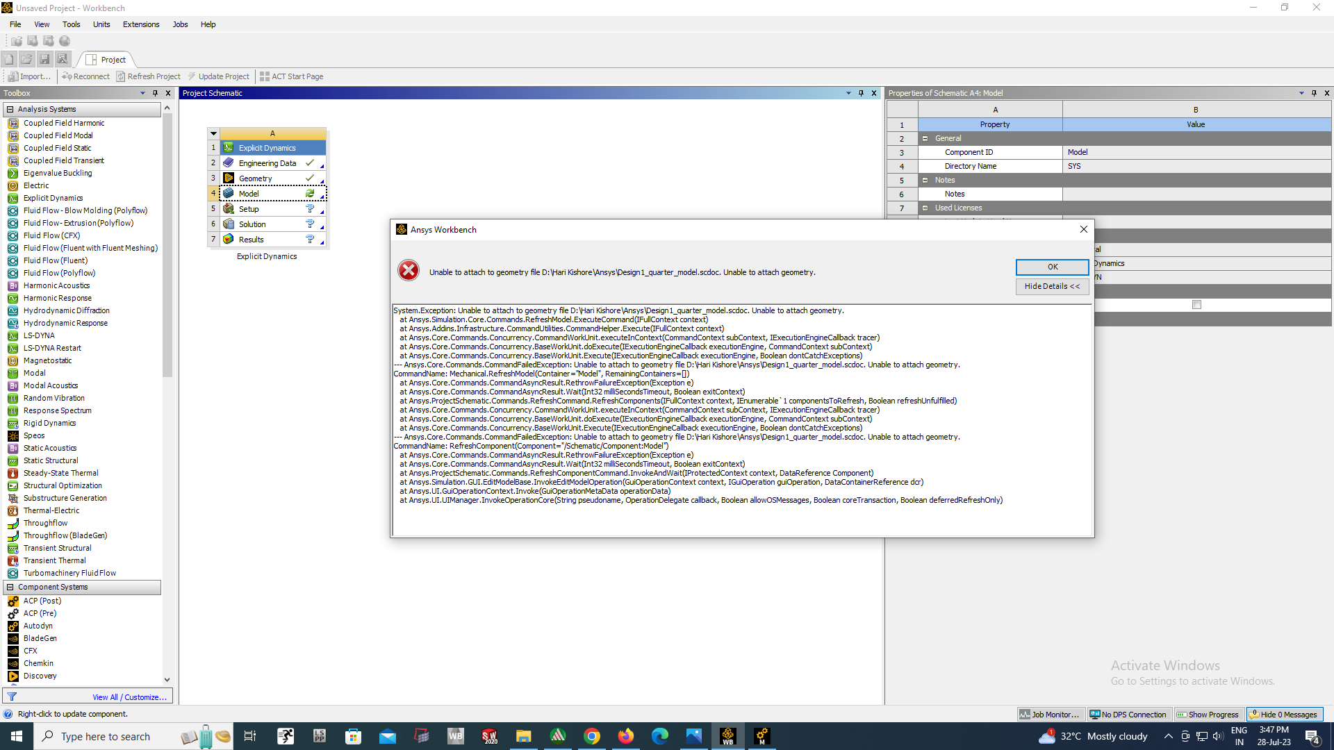

      Greetings,
                I had an error while opening the model after preparing geometry in spaceclaim.
      Here I'm attaching the image. thanks in advance.
