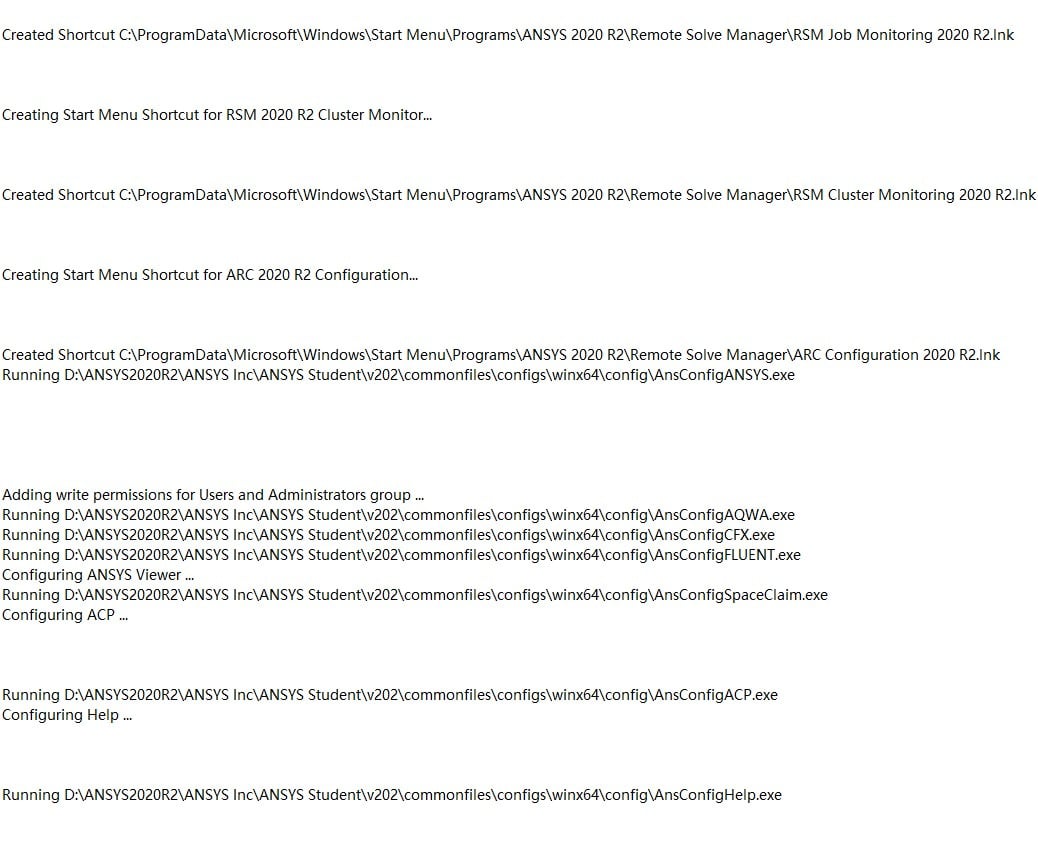

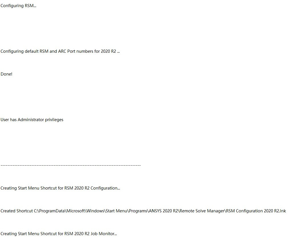

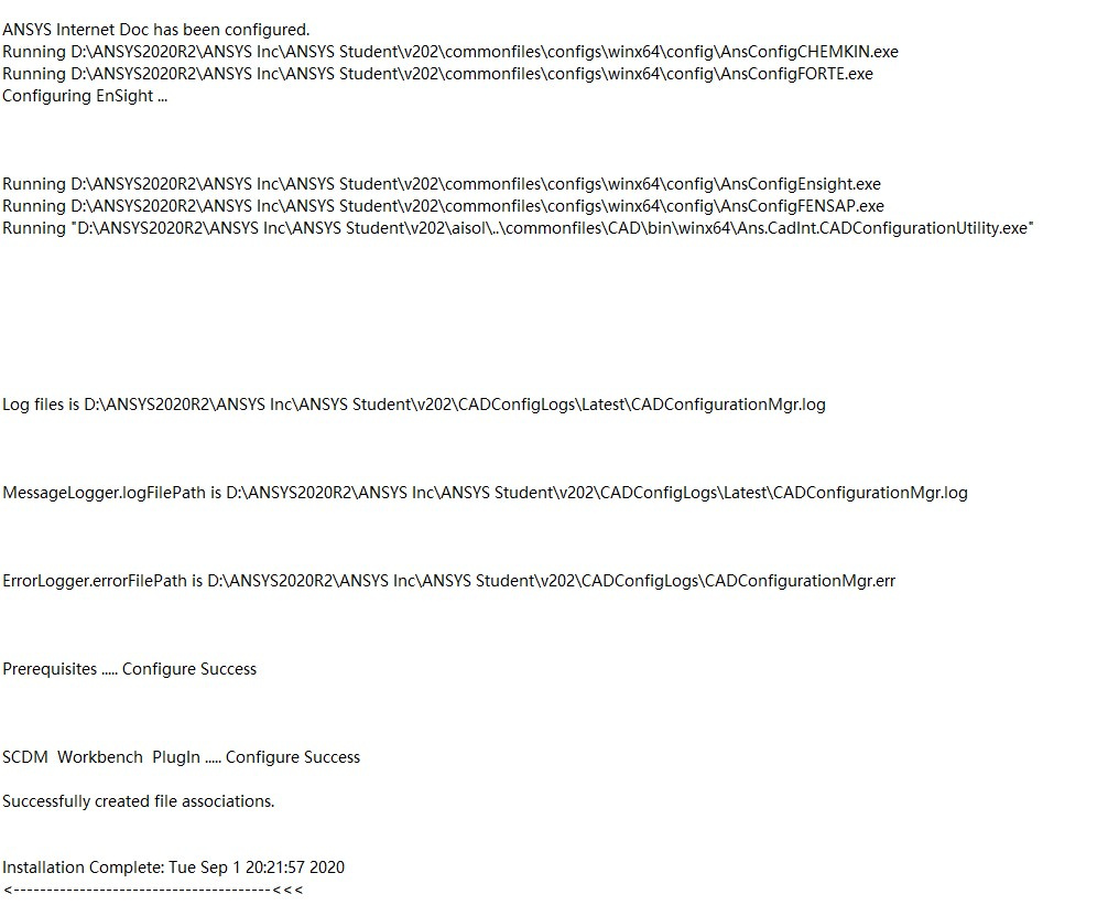

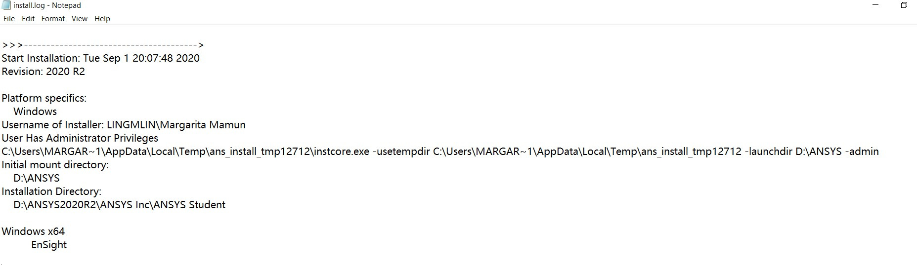

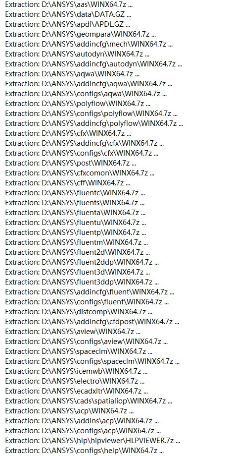

Ansys EmployeeOpen CMD Prompt and enter the following commandnsetnand post the output of it here.nnDo you have an install.err file under C:\Program Files\ANSYS Inc\ANSYS Student ? If so, post the content of it here.nnType dxdiag in CMD Prompt, and post the screenshots of the main page and 'Display' tabnSeptember 2, 2020 at 1:44 amSeptember 2, 2020 at 1:57 amSeptember 2, 2020 at 1:59 amSeptember 2, 2020 at 1:59 amSeptember 2, 2020 at 2:00 amSeptember 2, 2020 at 2:00 amSeptember 2, 2020 at 2:03 amJesseLin
SubscriberThank you sir, please see the screenshots I posted according to your instructions.nSeptember 2, 2020 at 6:37 amSeptember 2, 2020 at 6:37 amSeptember 2, 2020 at 9:33 pmtsiriaks

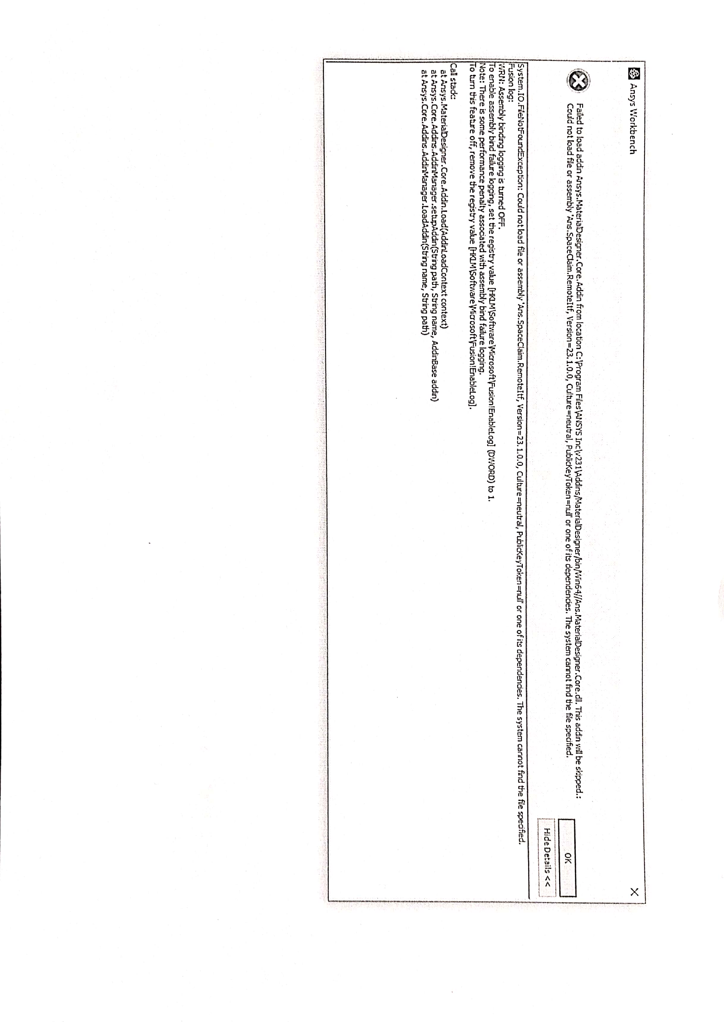

Subscriberthe same problem failed to load addin file in ansys workbench please help me immediately ...Â
