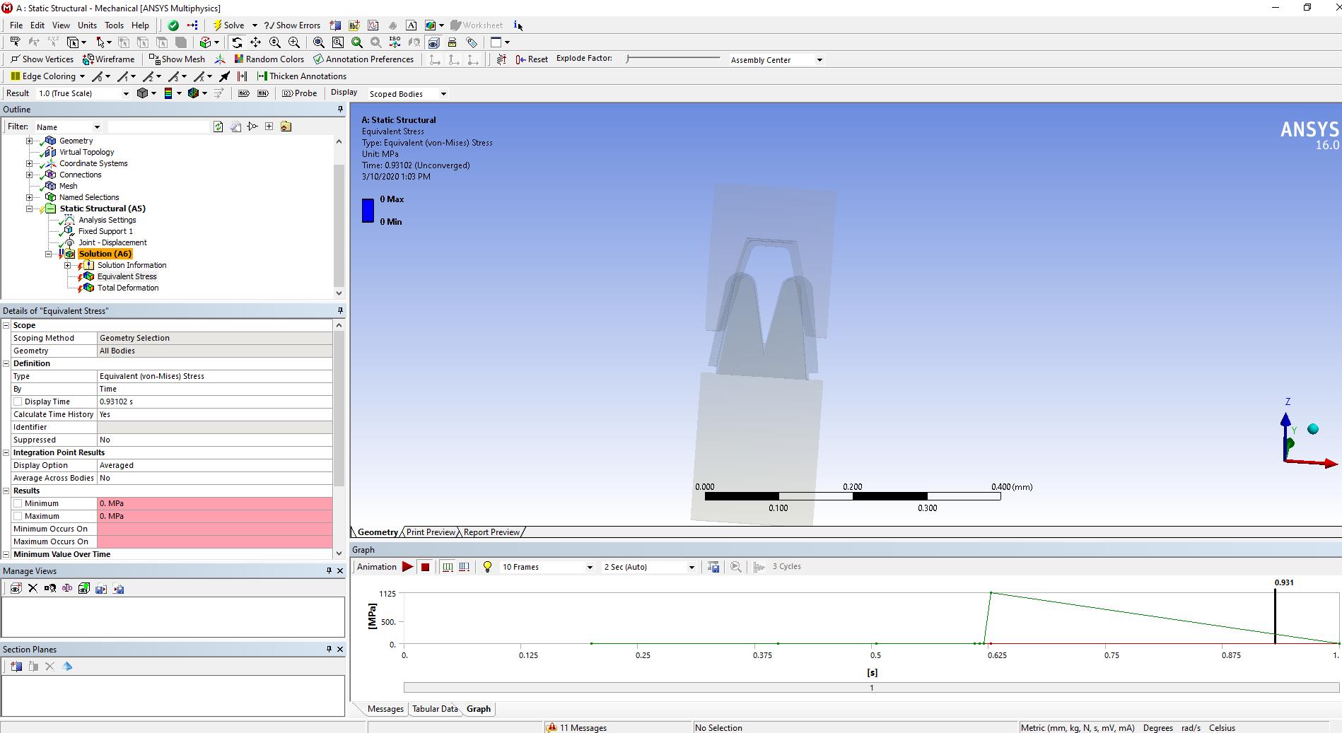

I had some trouble during workbench mechanical simulation.
I tried to push one connector from one side and make it join with another one and observed0 the maximum stress happened positions.Â
Yet the simulation can't provide good simulation results.
Seems the simulation isn't completed.
Could someone help me figure out how to correct it??

Forum ModeratorThere doesn't seem any error. only one warning as follows:
The maximum friction coefficient 0.4 is defined in the model. Switch to the unsymmetric solver (NROP,UNSYM) instead if convergence difficulty is encountered
Have you switched to Newton-Raphson option under Nonlinear controls in analysis settings to unsymmetric and retried?

SubscriberHi:
Could you show me how to switch to the unsymmetric solver and other solvers?
Thank you

SubscriberHi:
I tried the setting you suggested but still shows error during simulation and give me a different result.
The solve.out message shows as below.
Could you help me take a look?
Thank you
Element 47329 (type = 4, SOLID187) (and maybe other elements) has   Â
 become highly distorted. Excessive distortion of elements is usually Â
 a symptom indicating the need for corrective action elsewhere. Try  Â
 incrementing the load more slowly (increase the number of substeps or Â
 decrease the time step size). You may need to improve your mesh to  Â
 obtain elements with better aspect ratios. Also consider the behavior Â
 of materials, contact pairs, and/or constraint equations. If this   Â
 message appears in the first iteration of first substep, be sure to  Â
 perform element shape checking.                    Â

Forum Moderatorplease refrain from posting the entire solve.out file for the sake of readability of the thread. you can always search for the errors in the solve.out file and paste them here.
you are seeing multiple element distortion errors. As mentioned in the error:
"Excessive distortion of elements is usually a symptom indicating the need for corrective action elsewhere. Try incrementing the load more slowly (increase the number of substeps or decrease the time step size). You may need to improve your mesh to obtain elements with better aspect ratios. Also consider the behavior of materials, contact pairs, and/or constraint equations. If this message appears in the first iteration of first substep, be sure to perform element shape checking."

SubscriberHi:
These are all five error messages I can find in the solve.out file.
Please take a look at them.
Thank you

Did you try with more substeps? with improved mesh?Â
March 14, 2020 at 2:32 am
Han-yu
SubscriberHi:
I am not quite sure how to do it, could you guide me on how to do it?
The first step is to make the mesh smaller?
Or move two parts closer at beginning?
Thank you.
March 18, 2020 at 3:46 pm
Aniket Chavan
Forum Moderatorplease check mesh settings and analysis settings for these options.
https://ansyshelp.ansys.com/account/Secured?returnurl=/Views/Secured/corp/v195/wb_sim/ds_Apply_Mesh_Controls_step.html
https://ansyshelp.ansys.com/account/Secured?returnurl=/Views/Secured/corp/v195/wb_sim/ds_establish_analysis_settings.html
-Aniket
