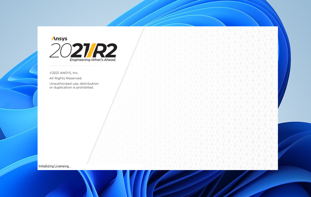

      I have ANSYS 2021R2, and I use my university license. It was working normally from a long time. Two days ago, I tried to open workbench, it started to launch givving me the launching window as shown below, and then within a second it closes without any error. Firstly, I tested the license through Licensing Client Settings, and it works. I tried a lot of solutions but nothing work.

      Hi AMR,
      Can you please check if any antivirus software is blocking the Ansys application?
      • Go to START > Event Viewer > Expand the Windows Logs and choose Application. In application log check if any Error is shown when you launch the workbench.
      Can you check while installation any error had occured?
      • Goto the install.err, install_licconfig.err, install.log, install_licconfig.log logs. (C:\Program Files\ANSYS Inc)
      Can you goto start menu and type %appdata%, rename the Ansys folder over there as Ansys.old and relaunch the application.
    • AMR KHEDR
      Yes, now it works thank you so much for your help
