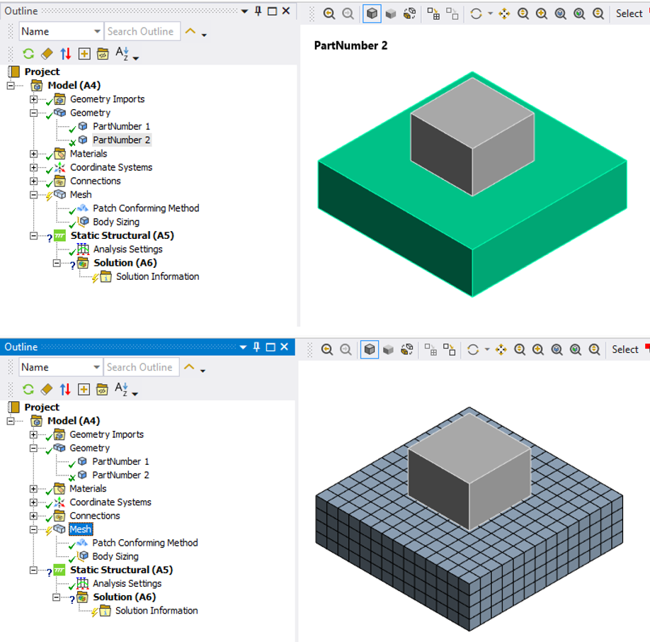

      If you want to perform operations inside Mechanical—such as meshing a specific part—you can send Python commands directly to the model using the SendCommand method. Here’s an example:
      system = GetSystem(Name="SYS")
      model = system.GetContainer(ComponentName="Model")
      # Refresh the system to pull updated geometry
      system.Refresh()
      # Open Mechanical interactively
      model.Edit(Interactive=True)
      # Define Mechanical Python code for selective meshing
      cmd = '''
      geodata = DataModel.GetObjectsByName("PartNumber 2")[0]
      geodata.GenerateMesh()
      # Send the script to Mechanical and close
      model.SendCommand(Language='Python', Command=cmd)
      model.Exit()

      I don't mean to be argumentative, but my testing has shown that the SendCommand() is smart enough to open Mechanical itself. So the model.Edit() is not necessary, which also means the model.Exit() is not necessary. The SendCommand() will automatically open in batch (no GUI display). The only time you need to explicity open Mechanical is when pictures are needed, such as generating the report. In this case the argument would always be Interactive=True, although you are free to set the argument to False if you want to explicity open it with your script but still want it to be in batch. There are some script command defects that need the Details or tabular view of an Outline object to refresh and display after creation before you can alter their settings.
