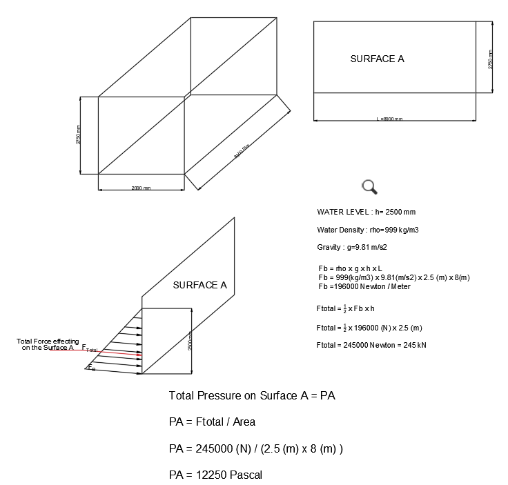

      Recently, to validate another analysis, I need to do these :
      This is the calculation that I made. I need the same pressure output on the static structural hydrostatic analysis.

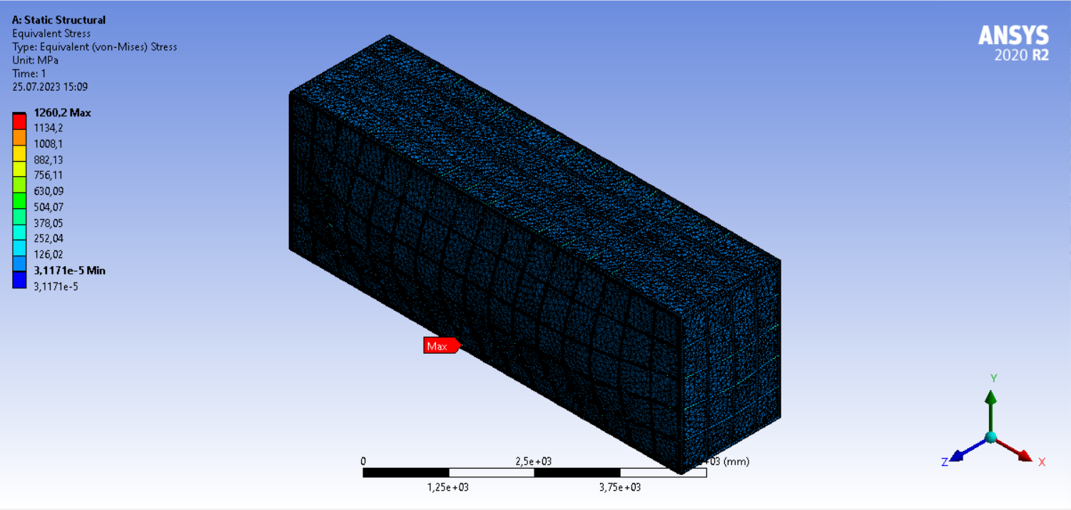

      I can set the analysis case, but the output that I can get is this :
      How can I get the total pressure effecting on the Surface A ?

      The hydrostatic pressure is not explicitly calculated in the code. It is accounted for in the equations "somewhere else" an thus it is not part of the total pressure. If you wanted to visualize this term, you could always create a Custom Field Function (CFF) for it.
