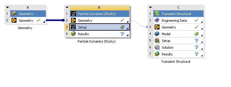

SubscriberHello, is anyone having issues importing geometry files from Workbench into Rocky? I've tried with the supplied discovery tutorial files. Tried my own .stl files. None are being obtained from upstream.

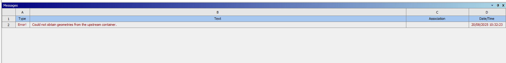

It opens rocky, shows "Obtaining geometry from upstream" for a while then eventually failed and shows the error below.
I know a similar post was done for fluent-rocky. I'm trying to do Rocky-Mechanical through workbench.

Ansys EmployeeHello,
did you install the 2025 R2 version directly from the download center via Automated Installer?
Could you try to uninstall all the products, delete the v252 folder and reinstall the products? I just tried it here with 2025 R2 and it worked.
