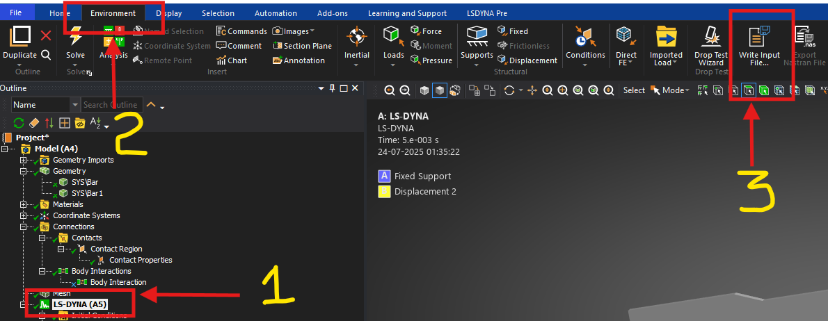

SubscriberHi I want to download extension file for workbench.
I want the keyword extension and the dyna extension
Is there a way to download the extension file of .wbex file?
I need this file to change the workbench file into keyword file of dyna.
Could I get a solution regarding this issue, please..?
Thank you
September 11, 2025 at 4:52 am
Nanda
Ansys EmployeeHello lilly0420,
I'm unsure whether Ansys offers any extensions like you mentioned. But what you need can be achieved natively. Please see details below:
For writing a .k file, you have to click on LS-DYNA module >> then ENVIRONMENT >> then Write Input file. Refer to the snapshot below.
Please let me know if you have any questions.

SubscriberThank you for your reply, problem is solved now
