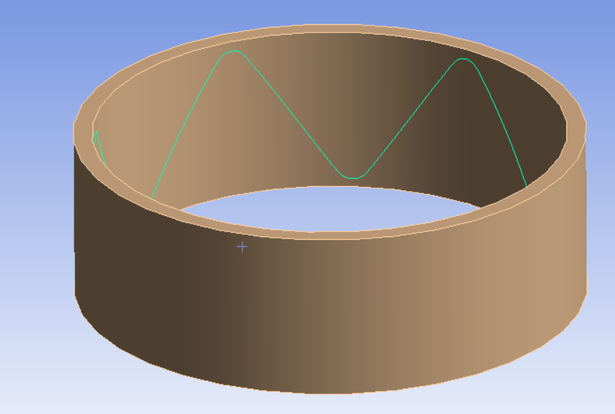

I've modelized a stent (wired body) surrounded by an aortic membrane (volumic body).

Is the stent a rigid body or fixed? You can model a stent as a volumic body and then define the contact between the stent and membrane. You can deploy symmetry as well. Please see if the following course helps you further:

SubscriberHi, the stent is a rigid body. I've prefered to modelize it as a wired body beacause it needs less nodes and elements.
I've found the solution if it can helps. In "Solution" - "post-treatment"-"beam section results" is "No" by default so it needs to be switch by "Yes".
February 7, 2022 at 3:15 pmyann
SubscriberHowever the contact force reaction doesn't work, I don't know why
