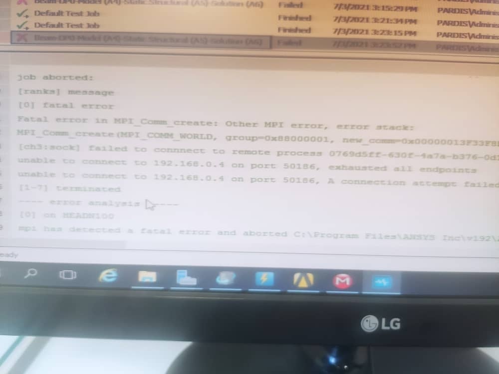

alichoopanian
Subscriberi am running ANSYS with windows server 2016 and HPC pack 2016 in cluster. it is multi node environment. when i use one node in simulation process evething is OK. but when increasing number of nodes. ERROR '' unable to connect to 192.168.0.4 on port 50186" happnes. how can i solve this problem.
July 9, 2021 at 4:26 pmmrife
Ansys Employeewell first we need to figure out what the cause is...use the MS HPC Job Manager to manually submit a job and run the mpipingpong test on those compute nodes. What happens? Mpipingpong test is a MS tool, so search their site for more info.
