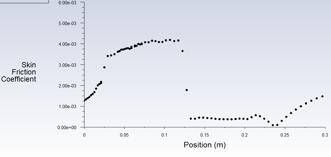

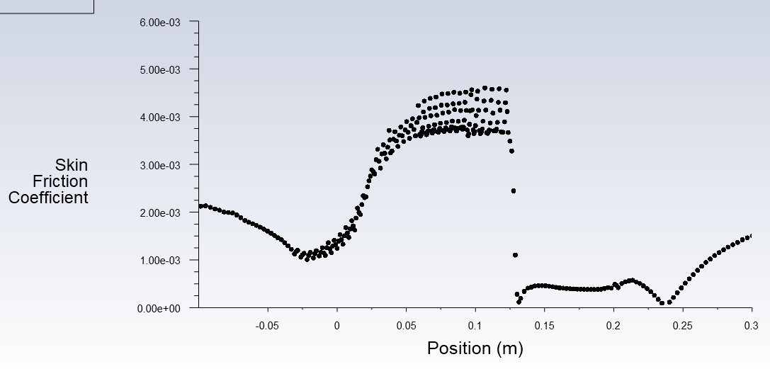

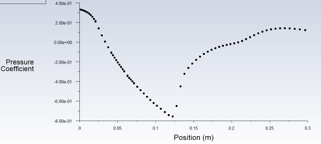

I'm using adaption to refine an existing solution but my final result plots along the wall oscillate wildly. They're oscillating around the right answer (from other papers etc.) but they seem highly unsteady. See images below for Cp and Cf along the wall. It's a 2D transonic flow case, and I'm using second-order Upwind scheme with density-based solver. I've tried adjusting Courant number from 0.1 to 5 and that didn't seem to help. I've run over 100,000 iterations per adaption iteration (10 iterations total) so it should be converged. The oscillations actually get progressively worse over each adaption iteration. I've tried the pressure-based solver with velocity coupling, didn't help. I tried third order MUSCL, also didn't fix it.
I've really exhausted a lot of options and I'm still unsure if it's a problem with the numerics or the grid or just something fundamentally wrong. I looked on other forums and some people have faced a similar issue but without a solution. I'm hoping someone here can help fix this, please? Or at least point to maybe where I'm going wrong.

SubscriberIt seems part of this issue lies in the hanging-node adaption for 2D grids, which Fluent is phasing out (according to the latest release). Extruding a 2D grid by one cell and using the PUMA (3D) adaption seems to have fixed this issue (see images below)
Curious as to why this is happening. I am interested in the math behind it. PUMA has 4:1 face interactions just like hanging-node has 2:1 which I suspected was the main issue. But I seem to be wrong in my hypothesis. Any explanations? Or papers I can refer to?
