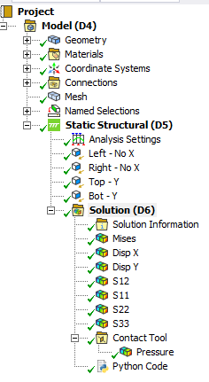

SubscriberI inserted some Python code in my Solution. I want the code to execute after the model is solved, so I set the Target Callback to "After Post". I then right-clicked to "Connect" the code. When I subsequently solve the model, the code executes flawlessly. However, if I close Mechanical and re-open it, the code is not connected, so I must "Connect" it again for the solver to proceed. The help file indicates that "Connect" only needs to be re-done if the Python code is changed (which it wasn't, in fact, nothing changed!). Below are images from before closing Mechanical and after re-opening it.

SubscriberI found the solution to my problem. Seems this is by design, but there is a workaround:
Resuming Databases with Python Code Objects (ansys.com)
