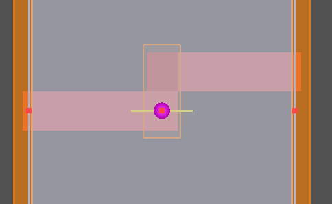

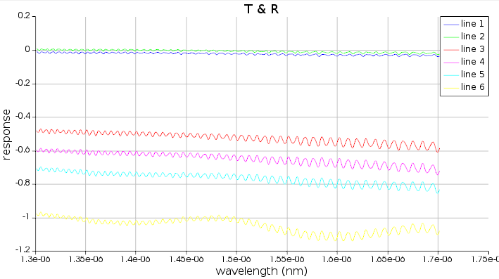

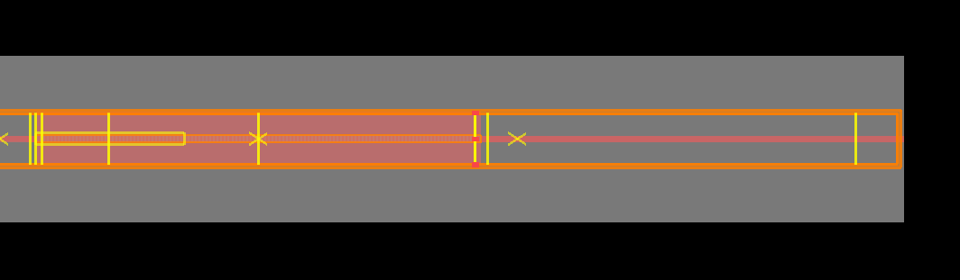

SubscriberGood day,ÂI'm observing the transmission along one arm consisting of the Waveguides with taper and the SIS Phase shifter.ÂFrom the geometry view, it is a simple SIS structure based on the Si/SiO2/Si and just plane layers.However, there is some continuous loss in the simulation among the monitors which are positioned at every point in the xy view.ÂAre there any points that I missed in the FDTD simulation?ÂHere are an XY view, the cross section, and transmission data. -

Hello, Thanks for using the forum.Â
Can you share a bit more deatails:
Source used, type of monitor, length and width of device.
Have you tried material fitting before running simulation?
Thanks and regards
Devika
