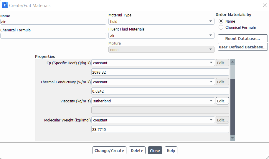

I have used isentropic relations to find the static pressure corresponding to M = 1 and given stagnation pressure and I am specifying the same values at Pressure inlet boundary condition.
And I am using air with specific heat ratio = 1.2, R = 349.7208 not the default value of 1.4 and Mw = 28
So to consider that difference, I am finding Specific Heat Cp using this relation [ y*R/(y-1) ] , then the molecular weight using the relation [ Universal Gas Constant/R ] and substituting in Air Material section.

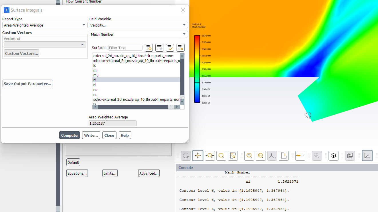

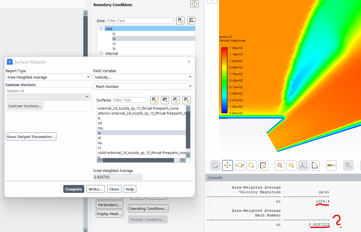

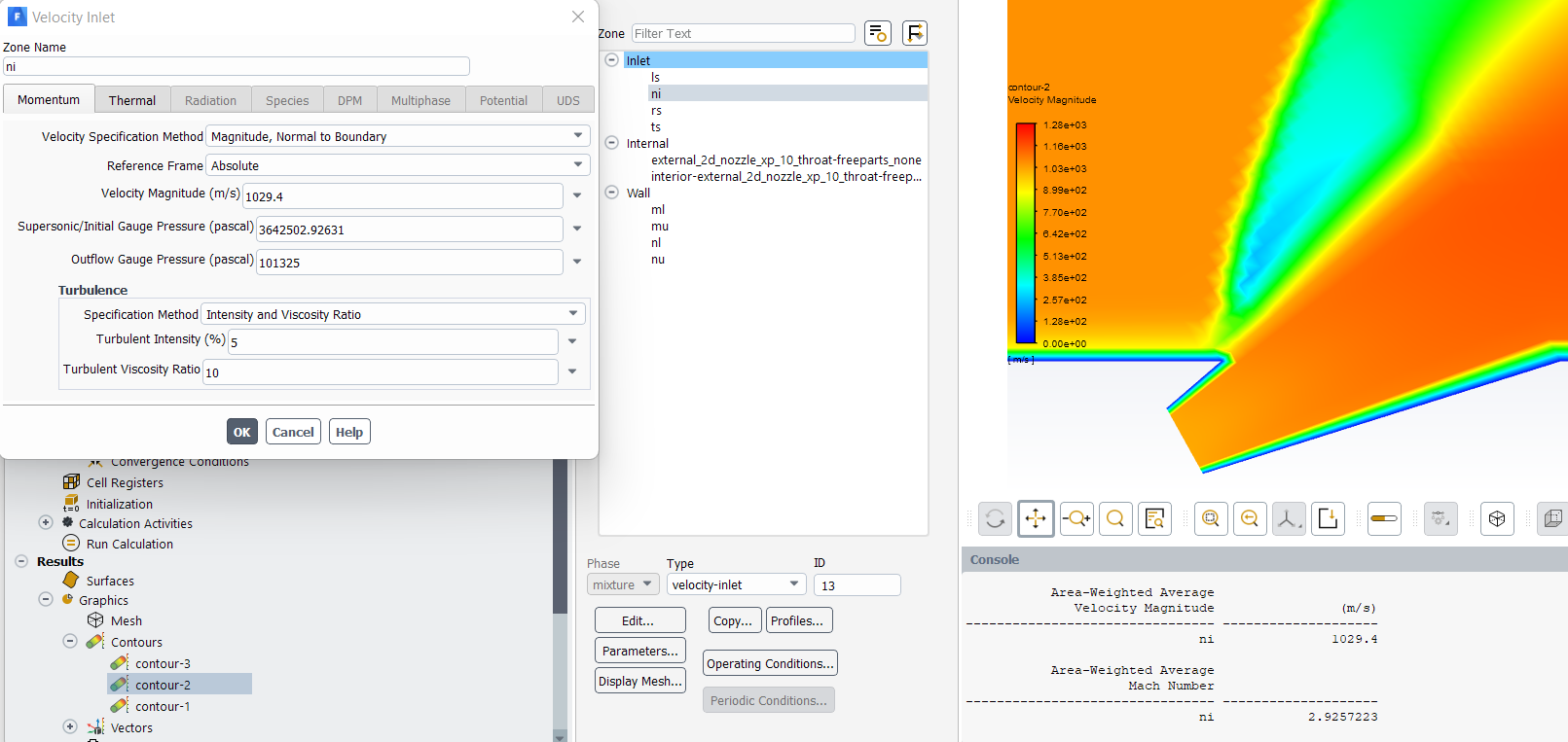

SubscriberSir, I am actually trying to solve supersonic viscous compressible cross flow problem through the diffuser using density based solver with k-w-SST turbulence model .
And I want the Mach number at the throat to be 1.
And I have read that, velocity inlet will give non physical answers when used for compressible flow. So, I doubt whether it is valid to use it or not.
Still I have run the simulation using both velocity inlet and mass flow inlet.
These are the results I am getting, Velocity at inlet corresponding to M = 1 is 1029.4 m/s using the relation V = sqrt(y R t) * M
And I can see that my area weighted avg at the inlet is exactly matching the given specified velocity at velocity inlet boundary condition, but area weighted average of Mach number at inlet, I am getting is 2.9257 instead of 1 which way off than I had using pressure inlet boundary condition.
But when I use mass flow inlet as inlet boundary condition, by specifying mass flow rate using choke nozzle relation. I am getting Mach number like around 1.23 but not exactly as 1.
Could you please tell me why is it happening like this?

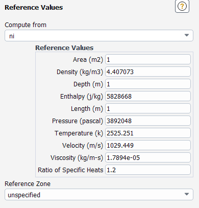

Sir, Is it anything related to reference values I have entered ? As it is a 2D problem, considering depth of 1m and diameter of diffuser inlet as D. I have specified both depth, as diameter of nozzle inlet and area as (1*D).
And rest of the parameters in reference value box are the default values.

SubscriberSir, Sir, I am just specifying supersonic inlet at diffuser inlet BCs and rest as Fairfield BCs except walls.
Yeah at diffuser inlet I am specifying Stagnation Pressure = 6.895 Mpa, Stagnation Temperature = 2777.7778 K and Static pressure corresponding to Mach number 1 using isentropic relationship.
And for Fairfield BCs I am specifying Supersonic Mach number and atmospheric BCs.
Yes sir it is under expanded jet case, Is it related to Compressible gas flow? As viscous and ideal gas is present so Value will not match exactly by using simple isentropic relations?
Or do I have to use some empirical relations?
Sir Could you please help?

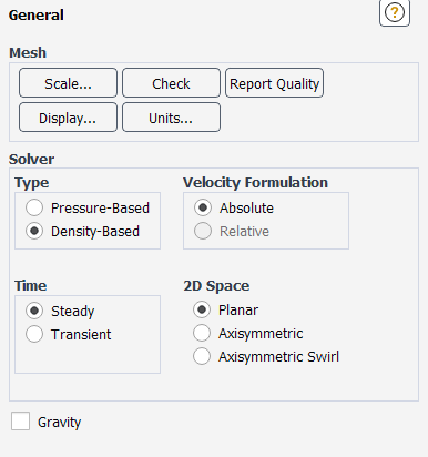

I have checked the scale option as well dimensions and units of domain is matching exactly as I created in Cad Modelling.
I am using k-w-SST model with default parameters with Energy Box Turned on.

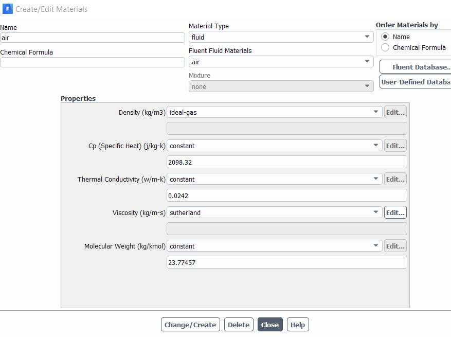

Under Create Material Tab,

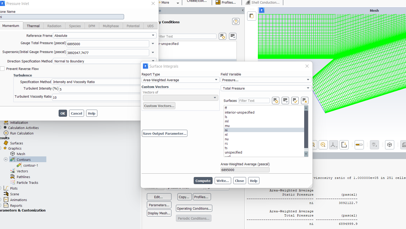

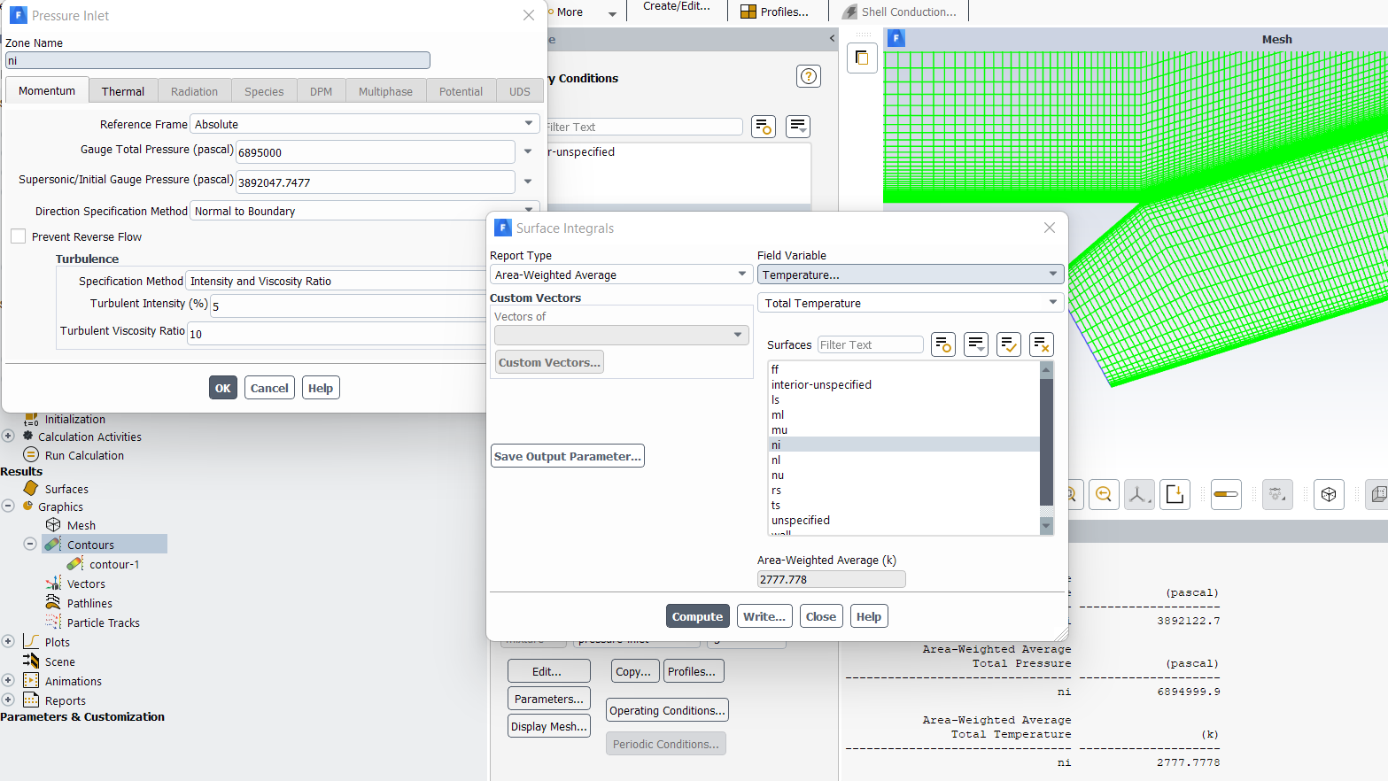

I want to specify exact Mach number = 1, at inlet of divergent section of nozzle.
And I am using air with specific heat ratio or isentropic coefficient = 1.2, R = 349.7208 not the default value of 1.4 and Mw = 28
Under Reference Values, I have used compute from Diffuser Nozzle Inlet and I have explicitly specified the ratio of specific heat as 1.2 from the default value of 1.4. And I didn't change other parameters.
Sir, I have done the simulation using Pressure inlet (Supersonic Diffuser Inlet Specifying Po, To and Static Pressure Corresponding to M = 1 using isentropic relations) and Fairfield BC (Specifying Ambient Condition and Desired External Mach Number) s and residuals are converging and the mass flux, drag monitor is also a flat curve without any fluctuations.
But I don't know for some reason I am not getting the exact Mach number as specified, as you can see that I have also used probe and calculatedarea averaged of 2Dinletof divergent section of nozzle it is not same as M =1.

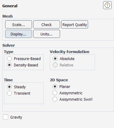

In Ansys fluent settings
Under General tab
I have check the scale, the domain dimensions and units are exactly matching as I have made in CAD modelling.

And I am using air with specific heat ratio or isentropic coefficient = 1.2, R*= 349.7208 (Gas Constant) not the default value of 1.4 and Mw = 28
So to consider that difference, I am finding Specific Heat Cp using this relation [ y*R/(y-1) ] , then the molecular weight using the relation [ Universal Gas Constant/R* ] and substituting in Air Material section.

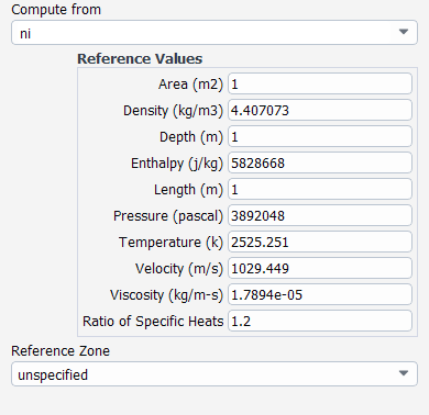

And Under Reference Value, I used Compute From Diffuser Nozzle Inlet and explicitly specified isentropic coefficient as 1.2 instead of default value of 1.4

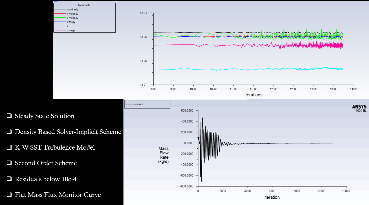

Sir, I have done the simulation and residuals are converging and the mass flux, drag monitor is also a flat curve without any fluctuations.

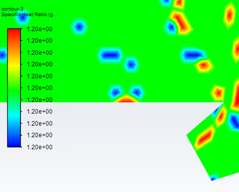

I have even checked the contour plot of gamma value to ensure that whether the changes made in air properties are applied or not, but according to the plot it seem the gamma value is same as the value I specified.

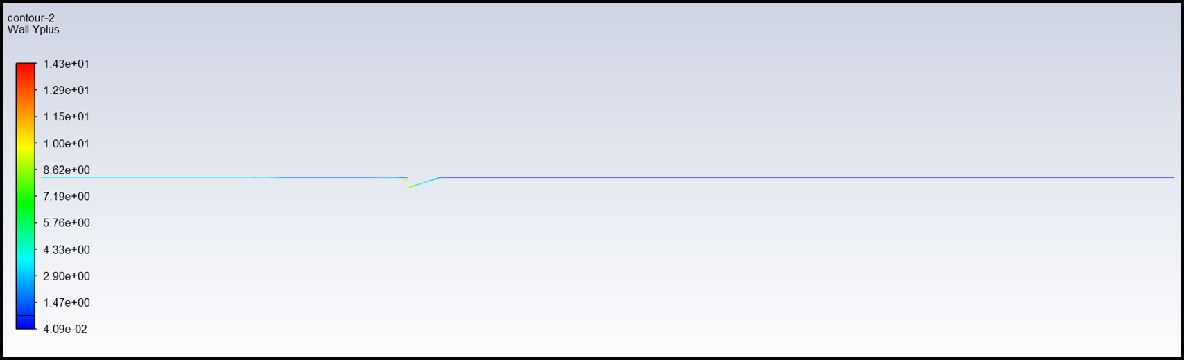

I've two questions for you - 1. How deep is your convergence? 2. How many layers do you have to resolve the subsonic region near the wall?
Karthik
March 9, 2022 at 2:31 pmKSD
SubscriberSir, My Residuals Curve looks like this
And my first cell cell height is 1e-5 m for both outer wall and diffuser wall , but Y+ value is of order 1 for walls outside of diffuser nozzle.
I have also done grid dependence test, and my solution are not fluctuating much with different grids.

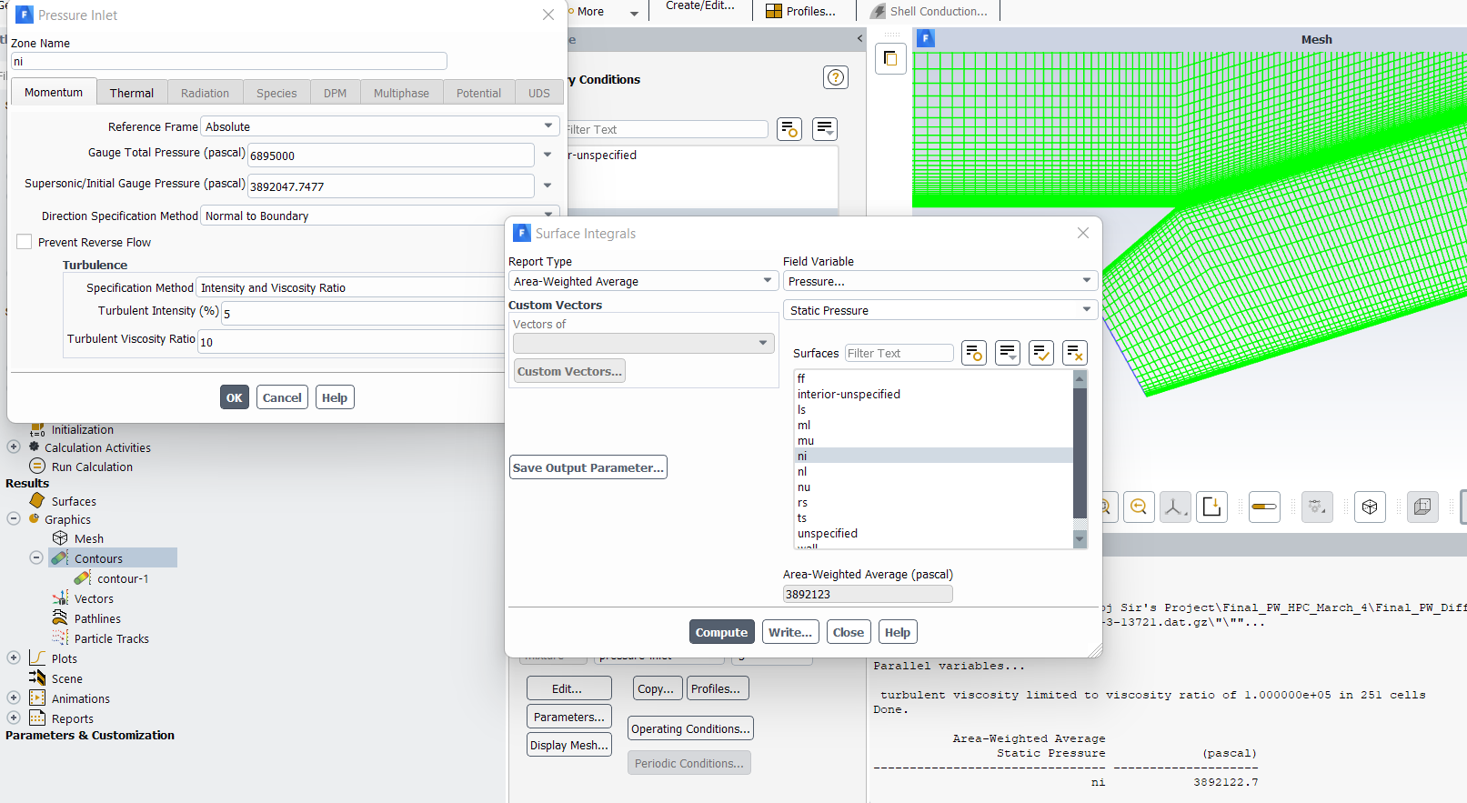

Sir the area weighted average value of Static Pressure and Total Pressure are as follows
I can see that static pressure value is not exactly as I have specified in Pressure Inlet, No Idea why so even though total pressure is matching. I have also specified Stagnation temperature of 2777.778 K whose area weighted avg at inlet is also matching.

March 11, 2022 at 9:51 amDrAmine
Ansys EmployeeThe issue is that Ma=1 as inlet is really hard. Now the solver predicts weak supersonic flow: here the supersonic gauge pressure is used. The latter is not used if you are sonic and subsonic. I have a feeling that one needs to add a sort of control here so that you perhaps start subsonic and then regulate it up. With the values you are getting for static pressure I can get a Mach number almost 1 (0.99999) so perhaps I think it is a post-processing issue: can you check that on your side?
