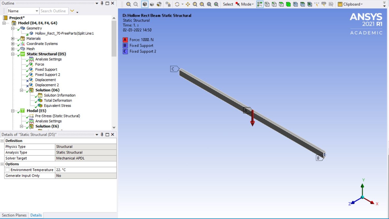

      Hello!
      I have been doing modal analysis of a fixed beam with a point load acting at its centre. The natural frequency of the beam which i have calculated is aroung 23Hz and in ansys modal analysis it is 112Hz in bending mode. (2nd mode in modal analysis)
      I am using a 170*80*4mm Rect Hollow beam of lenght 2m with both the ends fixed and a central load of 1000N acting on it. The mass of the beam per lenght is 5.45. the material is structural steel, E=210 GPA, Density=7405 kg/m^3, I=420565mm^4, y=35mm.
      Please reply with details of the hand calculation. I haven't seen a hand calculation that included a pre-stress condition, but I haven't looked for it either.
      If you create a Modal analysis without the Static Structural pre-stress, what are the first and second frequencies?
      Use SpaceClaim (or DesignModeler) to draw a line body and assign it the correct material and cross-section, then mesh it with beam elements. What are the first and second frequencies?

      Hi!
      I have used the below two formules to calculate the natural frequencies of the beam. and my results were around 23Hz.
      F= (1/2.pi) * (acceleration due to gravity / static deflection )^0.5
      F= (1/2.pi) * (stiffness/mass)^0.5
      I really dont understand where im getting it wrong.
      Would really appreciate your help
      Thanks Zabee.
    • Zabeeullah
      Hello
      Here is the link to my ansys setup:
      Thanks Zabee
