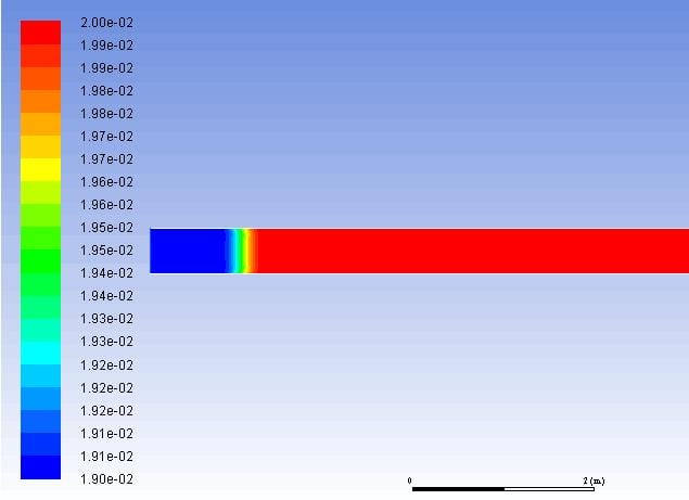

      I want to simulate the diffusion of ions in the presence of low concentrations of salt water in place of high concentrations of salt water.
      I use an unresponsive species transport model, laminar flow, unsteady state calculations
      When I set the mass transfer coefficient of the ionic material to zero, what happens between the two liquids is shown in the figure.
      I think the software also simulates convection.So I want to understand whether the principle of software simulation convection is in line with the situation I want to simulate.
      This picture shows the ion mass distribution cloud
      I think that if the mass transfer rate is zero, there should be no intermediate transition area

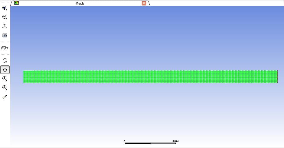

      The 2d model is 10m long and 20cm wide
      Entrance speed 0.1m/s
      Pressure outlet 0
      Do not consider the temperature
      What I am simulating is potassium chloride solution
      The concentration is converted to a mass percentage by the degree of mineralization. For example, 1000 mg/L can be considered as a 1000 mg/1000 g potassium sulfide solution.
      I set the concentration of the incoming liquid, and then set the concentration of potassium chloride solution in the container
      However, there is no potassium sulfide solution in the material library, so I replaced it with hydrogen ions first.

      I seem to have found my problem. I have set the speed too high. The actual fluid is already turbulent, so it causes diffusion, although the mass transfer coefficient is zero.
      I reduced the speed, controlled the Reynolds number within the laminar flow range, and the mass transfer rate was 0, and there was no diffusion between the liquids.
      One problem here is that if the boundary conditions I set are already turbulent, then laminar flow is selected for simulation. What will happen? Does the program simulate the turbulence? Or does it simulate a bunch of wrong results according to laminar flow?

      2. I set the mass transfer coefficient to zero to see if the convection has any effect on the simulation. After I set it to zero, I discovered that a concentration gradient band was still produced. Because the mass transfer coefficient has been set to zero, I think it is due to convection. So I want to know what principle or equations the software uses to simulate convection. I change my boundary conditions through principles or equations to reduce the impact of convection.
      3. Later, I found that the speed I set was 0.1m/s would cause turbulence, so I changed it to 0.001m/s. It was found that the impact of convection basically disappeared. I used the patch function on the initial interface to set the solution ion concentration in the vessel to a low concentration of 0.005, and the inlet fluid ion mass coefficient was set to 0.02. I do not know if this is right.
