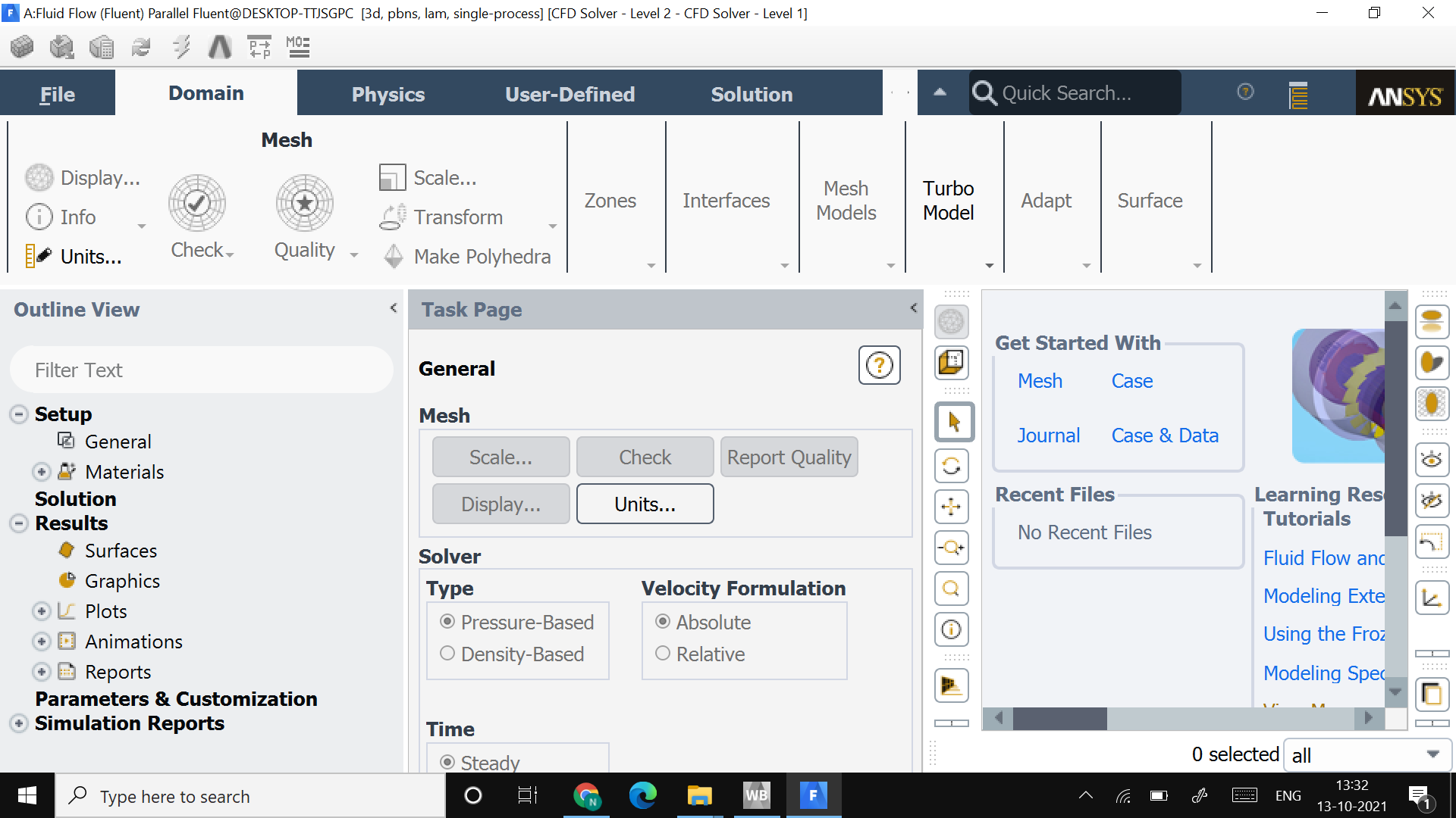

October 13, 2021 at 8:05 am
Nishit_Jajodia
SubscriberOctober 13, 2021 at 6:37 pmGeorge Karnos
Ansys EmployeeCheck your screen resolution.
Also,
If 4K Display is being used , try the following:
1.Change the High DPI settings under compatibility settings." Properties of workbench > Compatibility > Click on Override high DPI scaling "
2. Change the "Scaling performed by" option to "System(Enhanced)"
October 14, 2021 at 9:24 amNishit_Jajodia
SubscriberThank you. Changing DPI settings and "Scaling Performed by" worked.
October 14, 2021 at 12:12 pmGeorge Karnos
Ansys EmployeeExcellent!
I will go ahead and close this thread!
