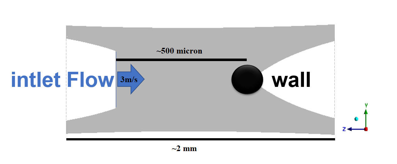

      This is the geometry of my microchannel. with 3m/s velocity and 0.5mm distance of inlet and wall, collision is inevitable. is there anything that I can do to resolve it?
    • Amine Ben Hadj Ali
      Also again: if you set the wall to be a trapping wall: do you see the particle trapped there Yes or No?

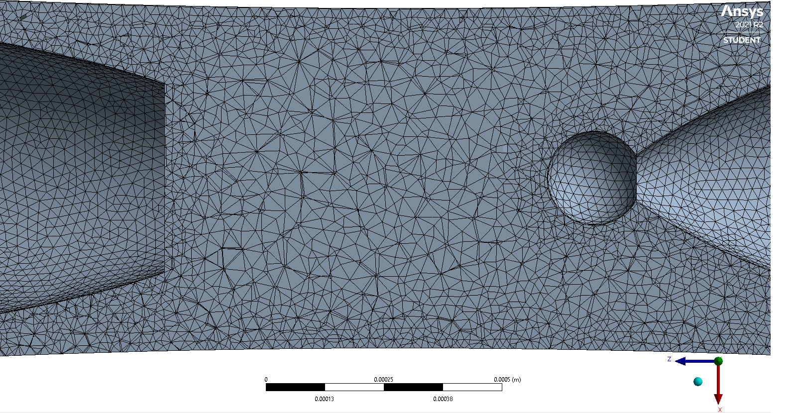

      Dear Dr. Amine this is my system mesh from inlet to the spherical wall:

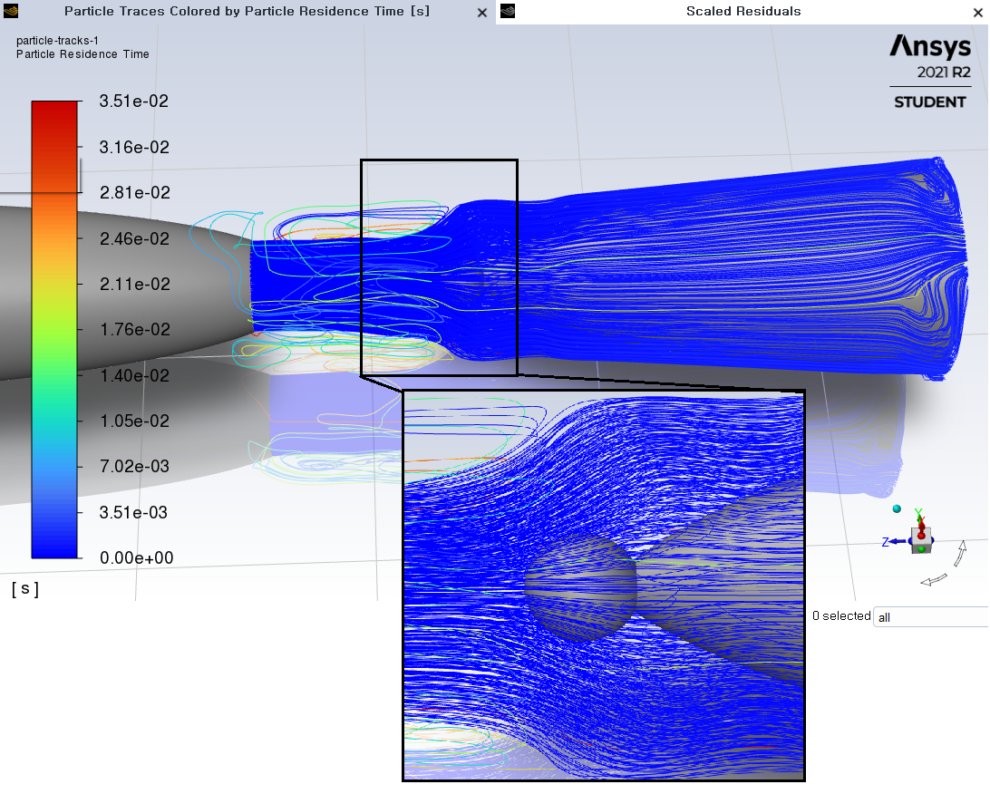

      and this is the particle track:

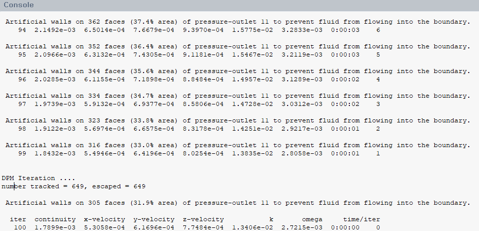

      and this is the summery of tracking:

      The mesh does not look good for me but it is my flavor as I prefer uniform mesh and boundary layer resolved meshes. Moreover your particles are all escaping so your erosion rate will be zero. You said at it was air particles are trapped on the wall. Water has higher viscosity and this will affect the particle relaxation time. Can you estimate the Stokes number based on the properties you have?
      Consider changing the position of the outlet to avoid any numerical backflow which you are now just "avoiding" via artificial wall creation.

      you place your outlet bit more downstream to avoid any numerical backflow. Sometimes backflow will also happen due to the physics. Please disable the "prevent backflow" option and try to figure out why you have a backflow.
      Your Stokes number is very low so the particles will be like passive tracers and travel with the flow.
    • Narges
      Thank you very much for your help. with increasing the particle relaxation time I can get non-zero wall force. I also I removed the "prevent backflow" option.
