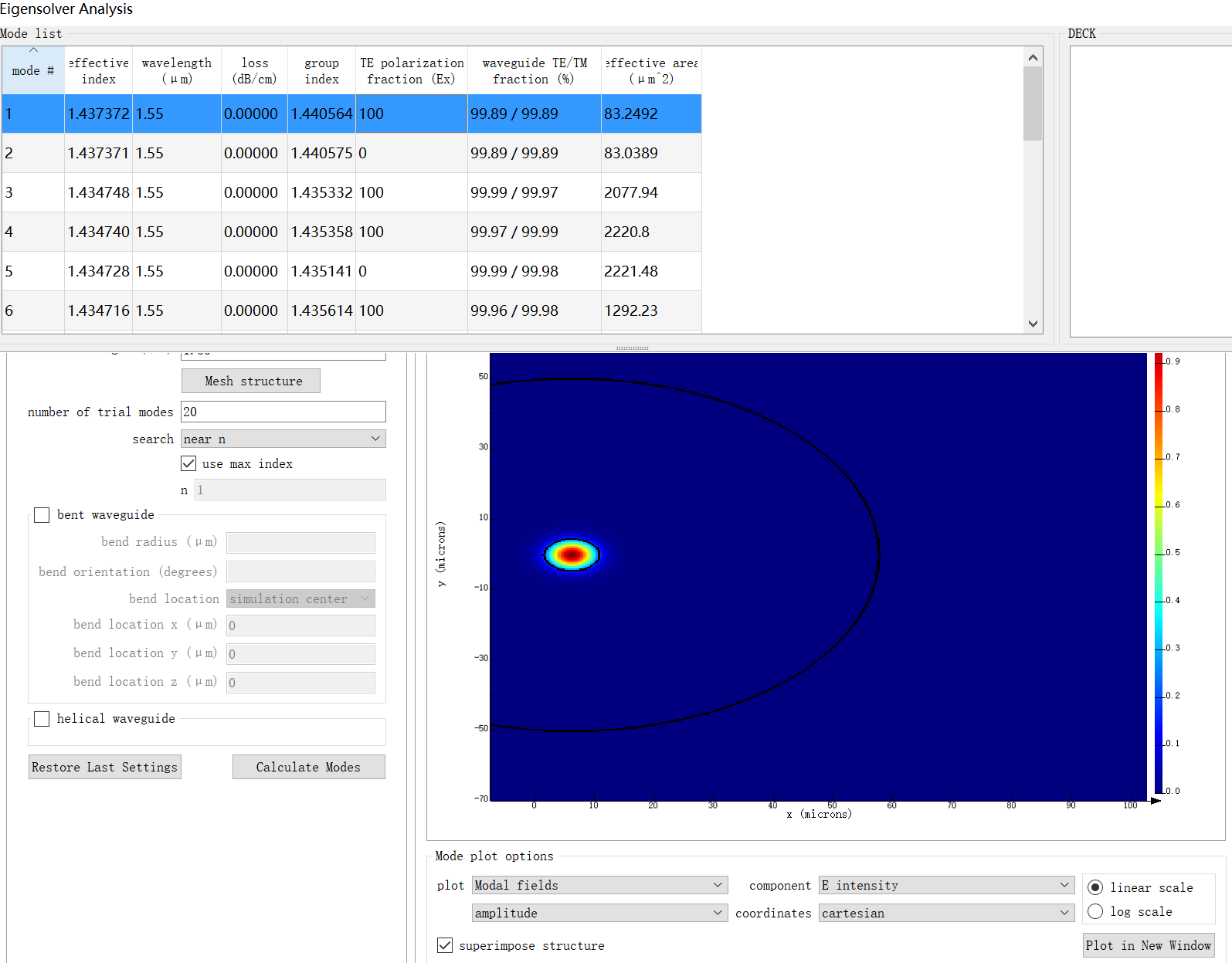

I am not farmilar with mode in fiber, but why the mode feature behaves exactly the opposite as what mode in waveguide?
The feature of fundamnetal TM mode in fiber behaves similarly as fundamental TE mode in waveguide, the feature of fundamental TE mode in fiber behaves similarly as fundamenatl TM mode in waveguide.

Ansys EmployeeAs you may know, different waveguide/fiber can support different types of modes. I would suggest you
1: copy the structure into MODE's FDE and check the mode property;
2: download online example and check its mode property.
Please note that in y direction it has used anti-symmetry BC to pick up the specific modes with that symmetry property. So the "fundamental" is actually not that fundamental when no symmetry BC is applied. The result showing "Fundamental TE" is 2nd order mode.

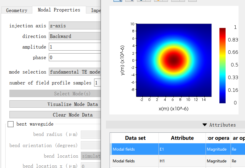

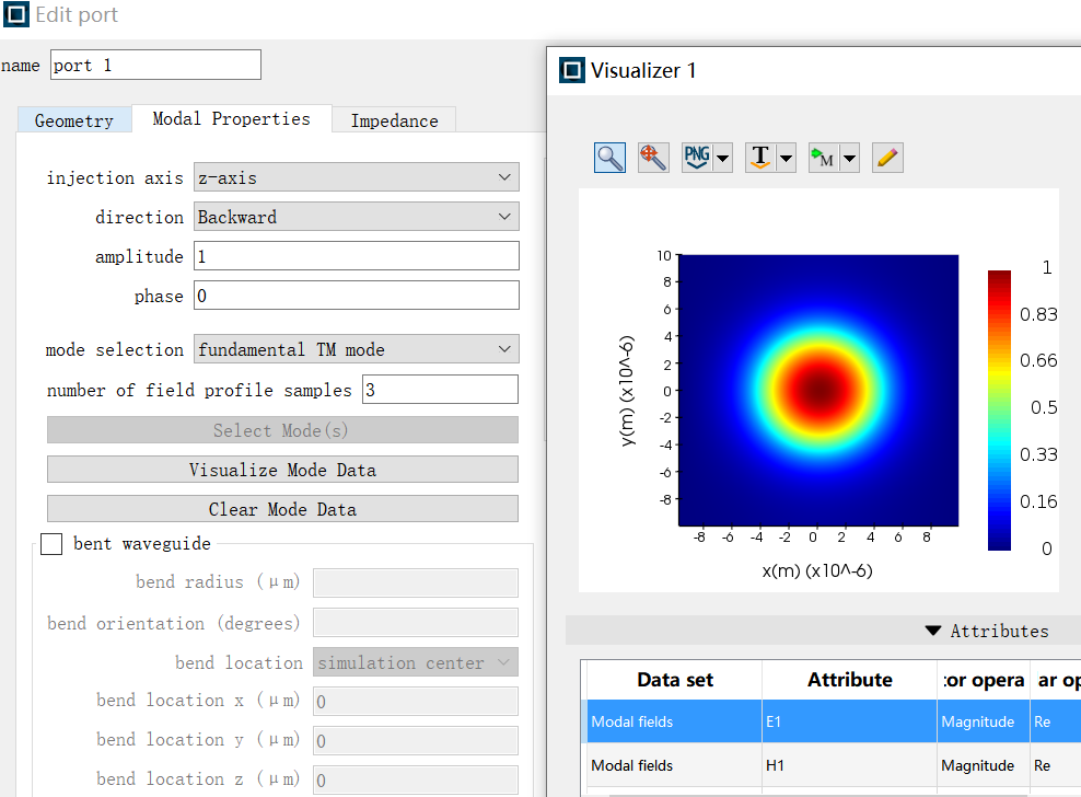

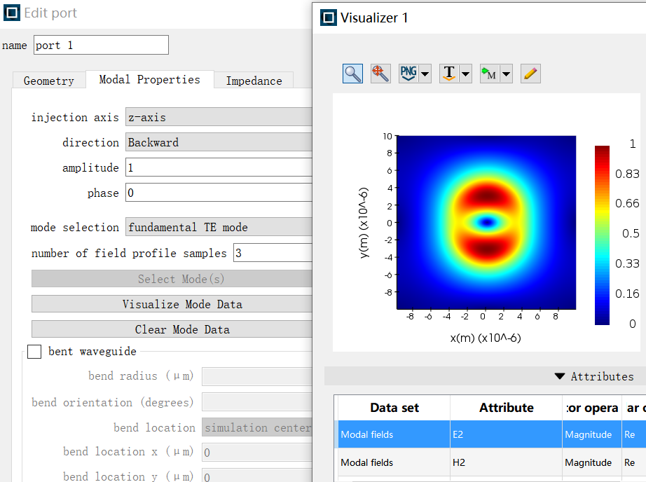

If I change boundary to "PML", then select fundamental TE mode, it shows like this:
if I select fundamental TM mode, it shows like this:

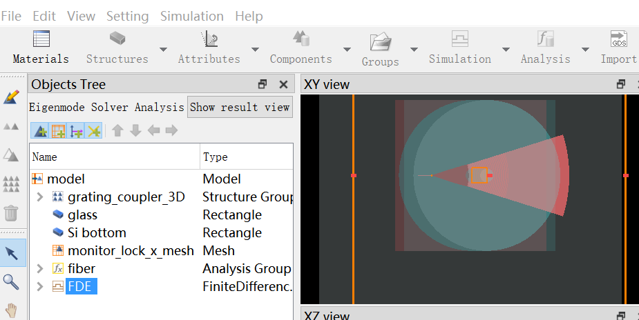

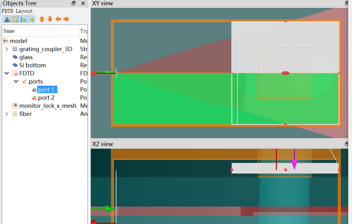

I have copied the geometry into MODE,and I get something like this:

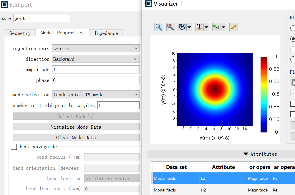

The following is the situation when z direction of FDE is in waveguide:
The following is the situation when z direction of FDE is in fiber:

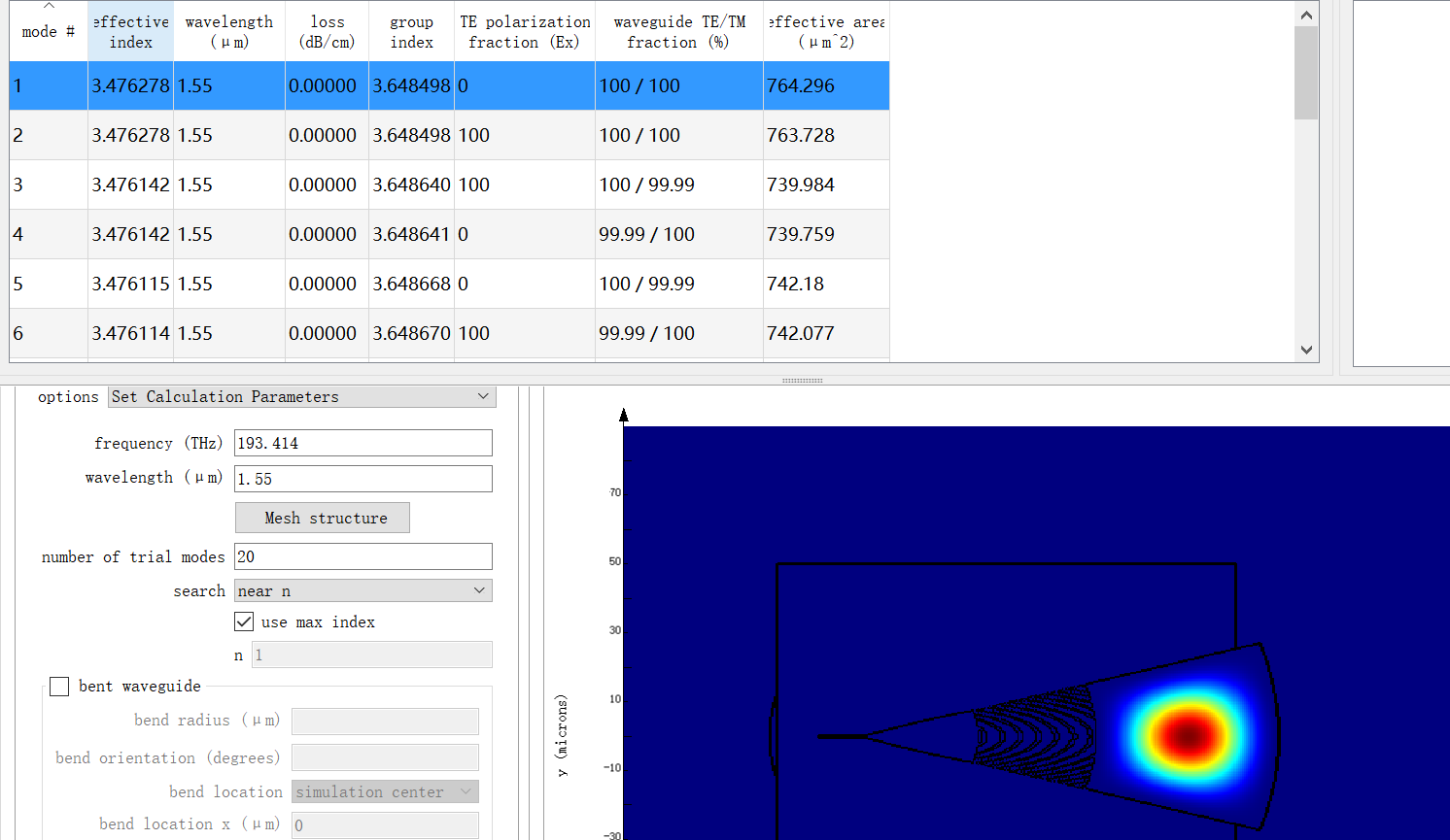

In example of "360042305334-grating-coupler.zip" and "360042800573-inverse-design-of-grating-coupler", the fundamental TE and fundamental TM mode shows like this:

Ansys EmployeeI should say that the word "fundamental" in the software may not be fundamental when symmetry BC is used. In text book, the fundamental modes are the first TE and TM modes. However, when symmetry BC is used, one of the true fundamental mode is suppressed. But, the software just uses "fundamental" for the higher order mode with other polarization. It is not smart enough.
You can compare the result by use of symmetry and no symmetry BC and compare their properties, in particular the polarization.
For the fiber, since it is circular, fundamental TE and TM modes have about the same neff and intensity but different polarization. The intensity profiles have a peak at the center.

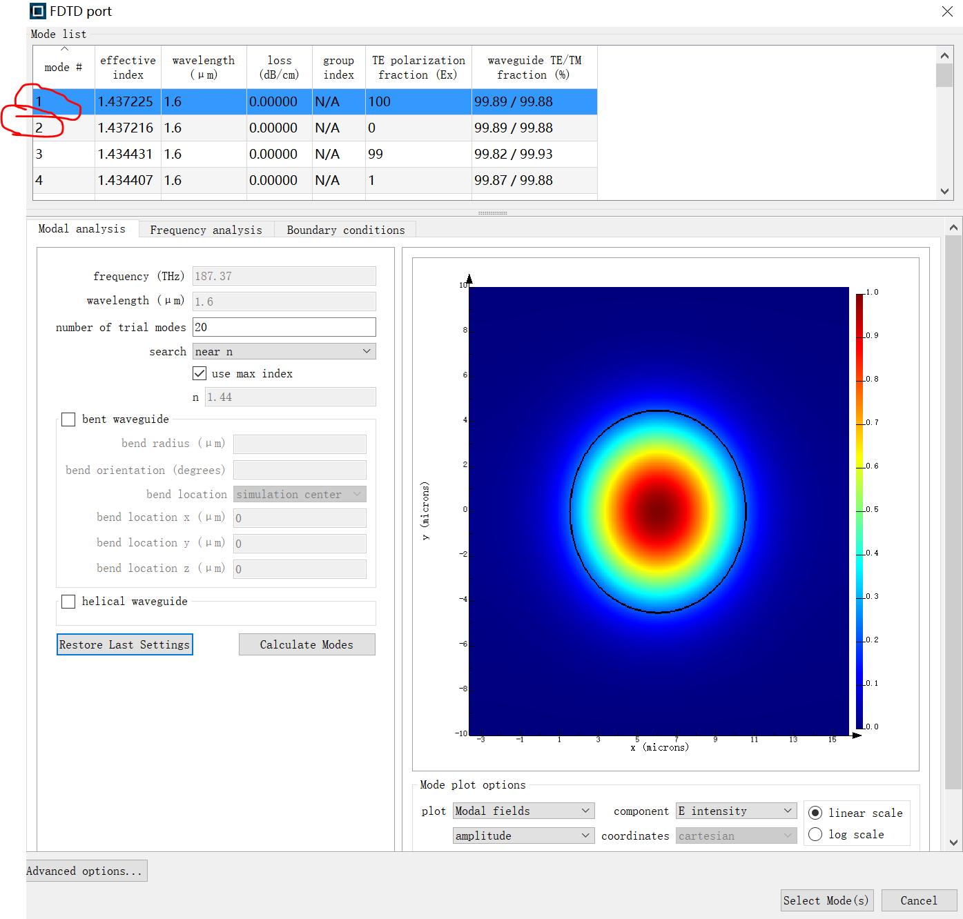

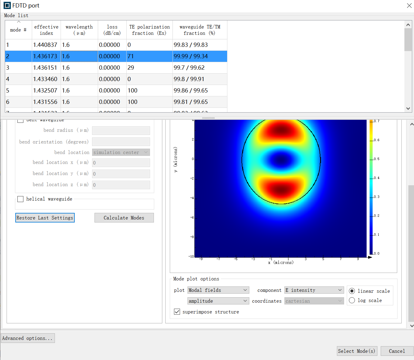

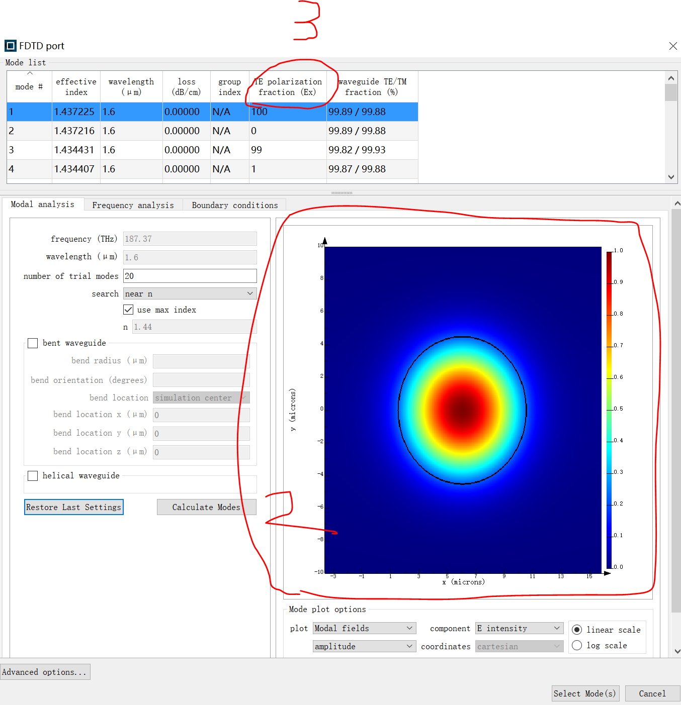

1.Setting the boundary to PML, which have no symmetry BC, I got modes like this, can I think that mode 1 (neff= 1.437225, TE polarization fraction=100%) is fundamental TE mode, mode 2 is fundamental TM mode?

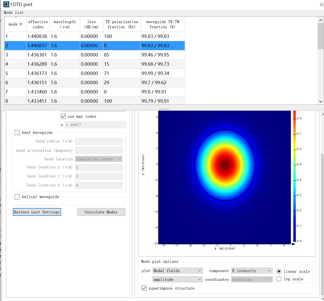

2 You said, the fundamental mode of TE and TM for fiber have the same neff and intensity, but have different polarization.
Does the intensity mean the fiture here(2)?
Then, how to tell which are TE modes, which are TM modes?
Does TE polarization fraction (3) geater than 1% mean it is TE mode? Does TE polarization fraction equal to 0 mean it is TM mode?
3.I find in the download example of "grating coupler", the mode by "user select" for PML and "anti-symetric" BC is different. It seems that the mode by "anti-symetric" is wrong, then why use anti-symetric BC in grating coupler example?
For PML BC
For "anti-symetric" BC

Ansys EmployeeA1: yes, you can. due to numerical error, their neff is slightly different; A2: For TE fraction, please refer this page: https://support.lumerical.com/hc/en-us/articles/360034396734-FDE-solver-analysis-Mode-List-and-Deck BTW: I also refer you to this post: Ansys Insight: 有关TE、TM模式以及模式光源的问题 For for contrast waveguide, traditional definition may not well fit. So please check the dominant field component. A3: it is not wrong. In this case, you should not count the mode number to determine if it is TE or TM. You should check the dominant field component instead. When symmetry BC is used, it will suppress the other polarization. Once you get more information from #2, you will know why.Viewing 5 reply threads- The topic ‘Why fundamental TE mode in fiber behaves like fundamental TE mode in waveguide?’ is closed to new replies.
