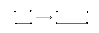

SubscribernPoisson's Ratio causes the high stress at the Fixed Support on a rectangular plate subject to an axial tensile force.nYou can see Poisson's Ratio happening on the plate because it got narrower when it got longer, and that is the definition of Poisson's Ratio.nAt the fixed support, the material is trying to get narrower, but the constraint prevents that, which creates stress.nIf you edit the material properties and type 0 for Poisson's Ratio, then there will not be a high stress at the fixed support because the material will not be trying to get narrower.nAnother way to eliminate the high stress without changing the material Poisson's Ratio is to replace the Fixed Support with a Displacement where X=0, Z = 0 on the edge, while leaving Y Free on that edge. Choose one vertex in the corner and set Y = 0. For a shell model, this is not enough constraints, since the plate can rotate about that edge, so the Fixed Rotation can be added to support the remaining DOF. The plate will get narrower and shrink toward the constrained corner point, avoiding any stress in the Y direction.n -

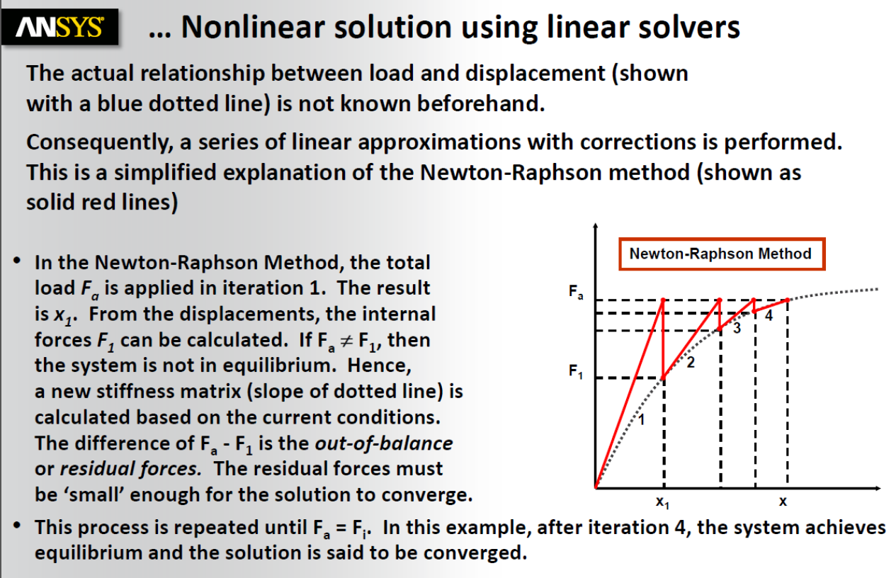

The animated GIF above illustrates Newton-Raphson iteration. The blue line is an unknown function, y = f(x). The search begins at an initial guess of x called x1. The value of y is computed and the slope at x1 is evaluated. Follow the slope down to Y=0 to get the next value of x called x2. Evaluate the function y2 = f(x2) and the slope at x2. Follow the slope to Y=0 to get the next value of x called x3. Continue the process until the evaluation of Y is close enough to zero to stop. nANSYS uses Newton-Raphson iteration to converge the solution of a nonlinear static structural model to the point of equilibrium. Equilibrium occurs when the difference between the internal forces and the applied forces becomes zero, like y = f(x) in the function above but in ANSYS, there is a vector of unknown displacements {x} to iterate on.n

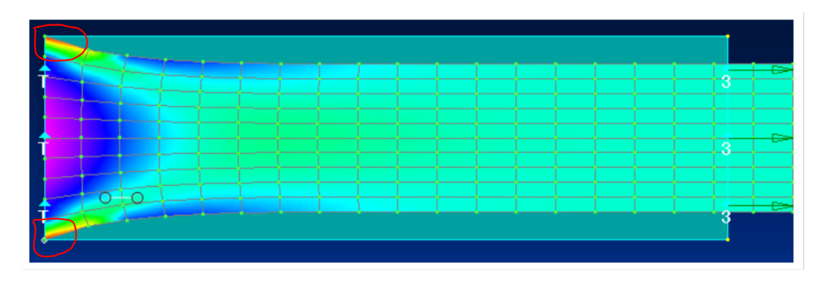

Why do I see a stress singularity in these red marked regions, and no where else ?.I found an article explaining stress singularity: https://www.linkedin.com/pulse/stress-singularities-concentrations-mesh-fea-marcos-ac%C3%ADn-gonz%C3%A1lez/nIn this article, following picture is shown:n
And the reason given is this:n
I didn't understand why the corner nodes should enforce a free edge condition i.e. Normal stress equal to zero? And how does it actually cause a singularity within FEA?n

SubscribernWhy does a large change in stiffness result in a failure to converge?nConsider this highly nonlinear Force-Displacement graph shown below.n
Try applying the iterative Newton-Raphson method on this function to find the unknown value of x for an applied load of Fa. Draw the sequence of trial values of x, starting at 0, and see how following the slope at each trial value will shoot the next trial value away from the correct value. The solver will only make a few iterations to try to converge on the correct value before it gives up. By forcing the solver to take many substeps, it should succeed in finding the correct value.n

Subscriberthat was a very good article, thank you. nThis video explains the difference between an acceptable singularity and a stress concentration. https://www.youtube.com/watch?v=-OHXl-mvR5U&ab_channel=DatawaveMarineSolutionsnHere is a good video on singularities. https://www.youtube.com/watch?v=ZP9nh4GOkIc&ab_channel=SimuTechGroupn
A simple way to understand a singularity in FEA is when a point force is applied to a single node on a solid body. Stress = Force / Area but the area of a single node is zero, and when you divide by zero, the answer is infinity.nIn the clamped end example above, the material is shrinking in the Y axis due to Poisson's Ratio. Away from the clamped end, the Y component of stress is zero. There is a Y component of force on each clamped node (except the center node is zero) to stretch the clamped edge to its fixed value. The Y component of force gets larger the further the node is from the center on the clamped edge. But there is no area at the corner node.n

SubscribernThe singularity at the corner node is a mathematical artifact of the finite element method, which delivers an infinite stress at the corner.nAway from the corner, there are , in reality, internal forces that are equal and opposite from the top half to the bottom half that stretch the material out to the fixed dimension at the base. The Vector Principal plot will show the arrows horizontal at the right end, but changing angle to point toward the top and bottom corners at the left end.n -

Subscriberthank you once again. So what you have said implies that the stress concentrations which starts to form a few elements before the left end boundary condition is real because of the existence of force in the Y direction at the left end. This force in the Y direction actually makes the stresses in those few elements to rise, and the load paths (or the vector principal stresses) will be a result of the stress in the X direction (due to external force) and the stress in the Y direction (arising due to fixed left end boundary condition).nHow do we determine critical distance, in this case, of the singularity happening at the top and bottom corner nodes of the left end? [beyond which the St. Venant's principal is going to be valid].n -

SubscribernThe distance for a stress disturbance to be significantly reduced is 2 times the maximum dimension in the cut face. It is not a critical distance, just a guideline.nYou other question shows an example of this. /forum/discussion/comment/101294#Comment_101294nHere is a video on that. https://www.youtube.com/watch?v=Fv23fkX0YhQn -

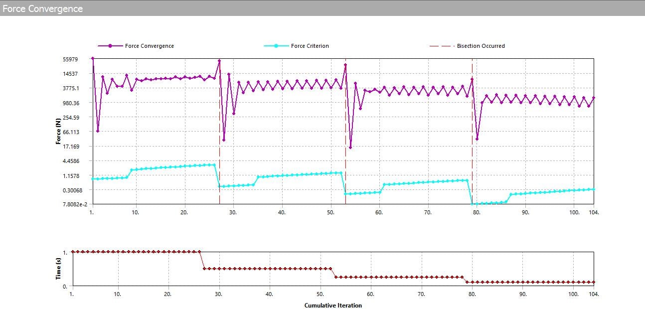

SubscribernThey are all the same error but there can be different corrective actions based on the shape of the N-R Force Convergence Plot. Look at the image below. See how from iteration 40 to 56, the purple curve was almost about to cross the aqua curve and convergence would have happened, if only the solver kept iterating, but it stops after 26 iterations.n
The corrective action is to tell the solver to keep going with the NEQIT command. Read this discussion: n/forum/discussion/2550/understanding-force-convergence-solution-outputnThen there are the N-R Force Convergence Plots where the two curves just remain parallel and never trend toward crossing one another. In that case, more iterations won't help. n
This lack of convergence is sometimes caused by elements that are too large or poorly shaped, and cannot find equilibrium. The corrective action is to remesh with smaller, better shaped elements. But you have to know which elements have the problem, and this is where the maximum value on the Newton Raphson Residual plots under the Solution Information folder show you where those elements are.n

SubscribernLook at how many iterations each one takes to get to the end.nFor example, if the 10 substep case used 2 iterations per substep, that is a total of 20 iterations.nYou might find that the 2 substep case used 10 iterations per substep, for a total of 20 iterations.nIn this example, the same amount of computation was done, the difference is how frequently output was saved.nSince the convergence criteria was the same for both cases, the accuracy should be very similar for both.n -

SubscribernThe force criterion is the same in both cases. In the 2-step solution, on the first iteration, the force is far from the criterion, so it does 10 more until it gets below.nIn the 10-step solution, on the first substep, the force is close to the criterion on the first iteration, and it get below on the second iteration. That is because the load is only 1/5 of the 2-step solution.nThe accuracy is similar for each solution setup.n -
