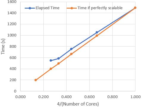

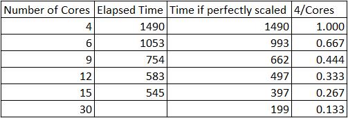

      ELAPSED TIME VS. NUMBER OF CORES
      It would be great if the elapsed time was cut in half when the number of cores doubled. That almost happens when you go from 1 core to 2 and from 2 cores to 4, but it starts to go off that trend when the cores increase to 8, 16, 32, etc.
      I reduced the element size to 0.25 m to get a much bigger model and solved that model using the Direct solver (Distributed), five times, using the following number of cores and recorded the Elapsed Time in seconds.
      Here is the data in a graph. The blue line is the actual time, the orange line is the perfectly scalable line. You can see that the blue line is flattening out and that 30 cores is not going to reduce the time by much.
      If the x-axis is plotted as 4/(Number of Cores) then a straight line will be made for the perfectly scalable time.
