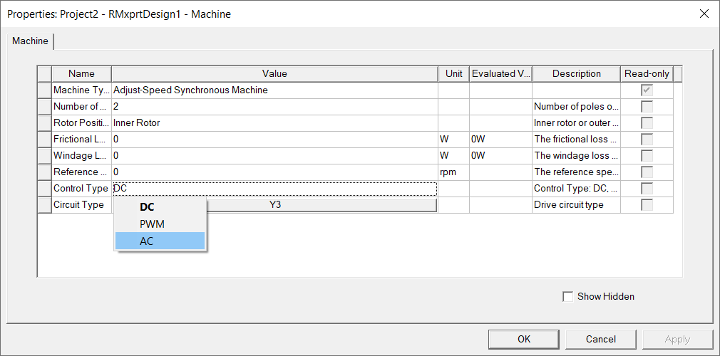

      I don't get the option of choosing generator as a solution setup for the adjust-speed synchronous machine in RMxprt R2019.
      This option was available in previous versions.
      How can that be fixed ?
    • NKC
      If you select the control type to AC in the machine settings then you can change the operation type to generator in solution setup.

    • hani.sadek_i
      Thank you Navya !
