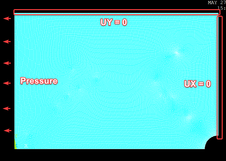

SubscriberI am trying to run the APDL script
where Uy = 0 and UX = 0 lines represent symmetries. however, I get the error message:

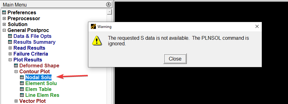

Warning: The requested S data is not available. The PLNSOL command is ignored.
when trying to plot the von Mises stress:

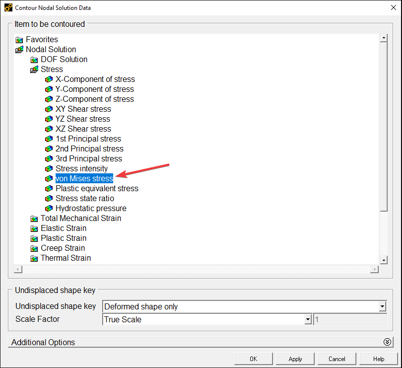

Subscriberusing this reply, I was able to solve the problem:
/POST1 ! Enter the General Postprocessor
/DSCALE,ALL,1 ! Use true scale (scale displacements by 1.0)
SET,LAST! read the last data set
PLNSOL,S,EQV,0,1.0 ! Plot equivalent (von Mises) stress

That is great - I think though you are likely missing though a symmetry bc (Y=0) on the bottom edge (ZX plane).
