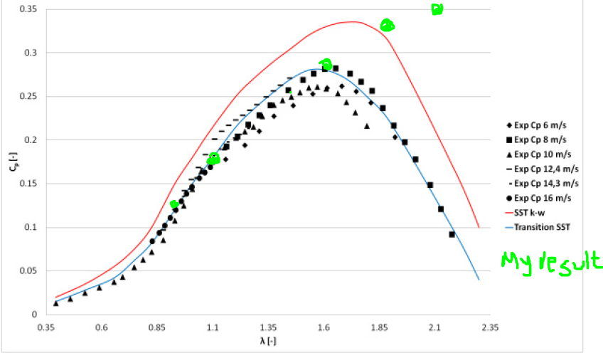

      Assuming it's set up and you're monitoring the correct value with the correct axis can you check it's not just that you've not reached the peak? Pictures will help.

      Dear sir I am trying to replicate the results of a paper, so it's unlikely that the peak will be far-off. Here's a picture that shows the paper's results, experimental results, and my result. I am trying to get the transition SST model and according to the paper, it is run at inlet velocity 10m/s:

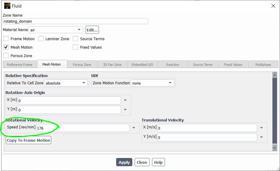

      So far I have understood, to get the Cp vs TSR curve, I have to change the turbine's angular velocity here:
      This is run at 176 rev/min i.e. 18.4307 rad/s. For 10m/s inlet, the TSR will be (omega*turbine Radius)/freestream Velocity=(18.4307*1.125)/10=2.30.

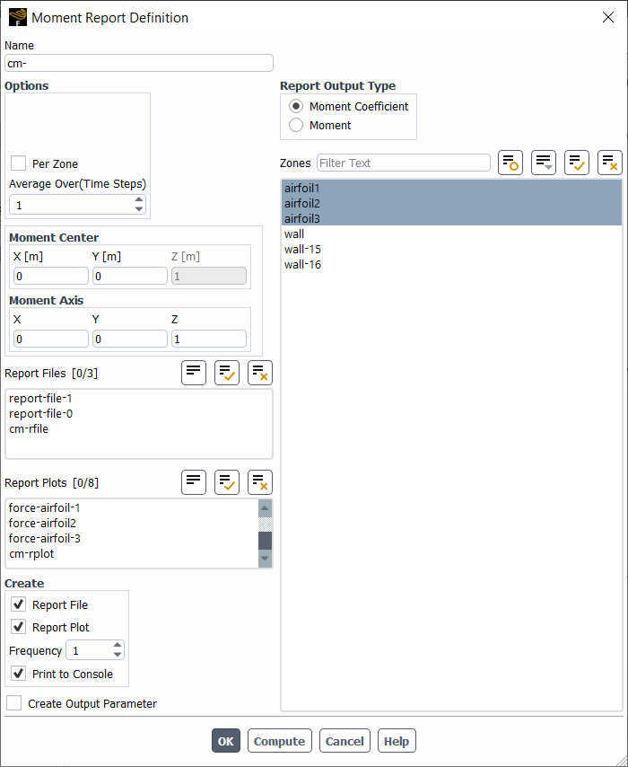

      This way, for each TSR point, I have to run the simulation and get the average moment coefficient value(Cm):
      Then, I calculated Cp=Cm*TSR. This way I calculated but always got an increasing value of Cp.

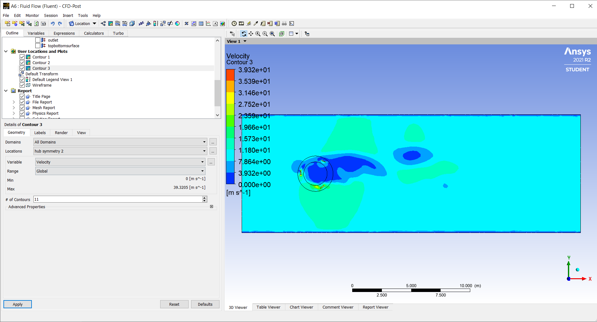

      To confirm, the system spins anti-clockwise? Please post some contour plots.
    • mmt
      Sir,
      Yes, it rotates anti-clockwise. I am posting the velocity contour here:

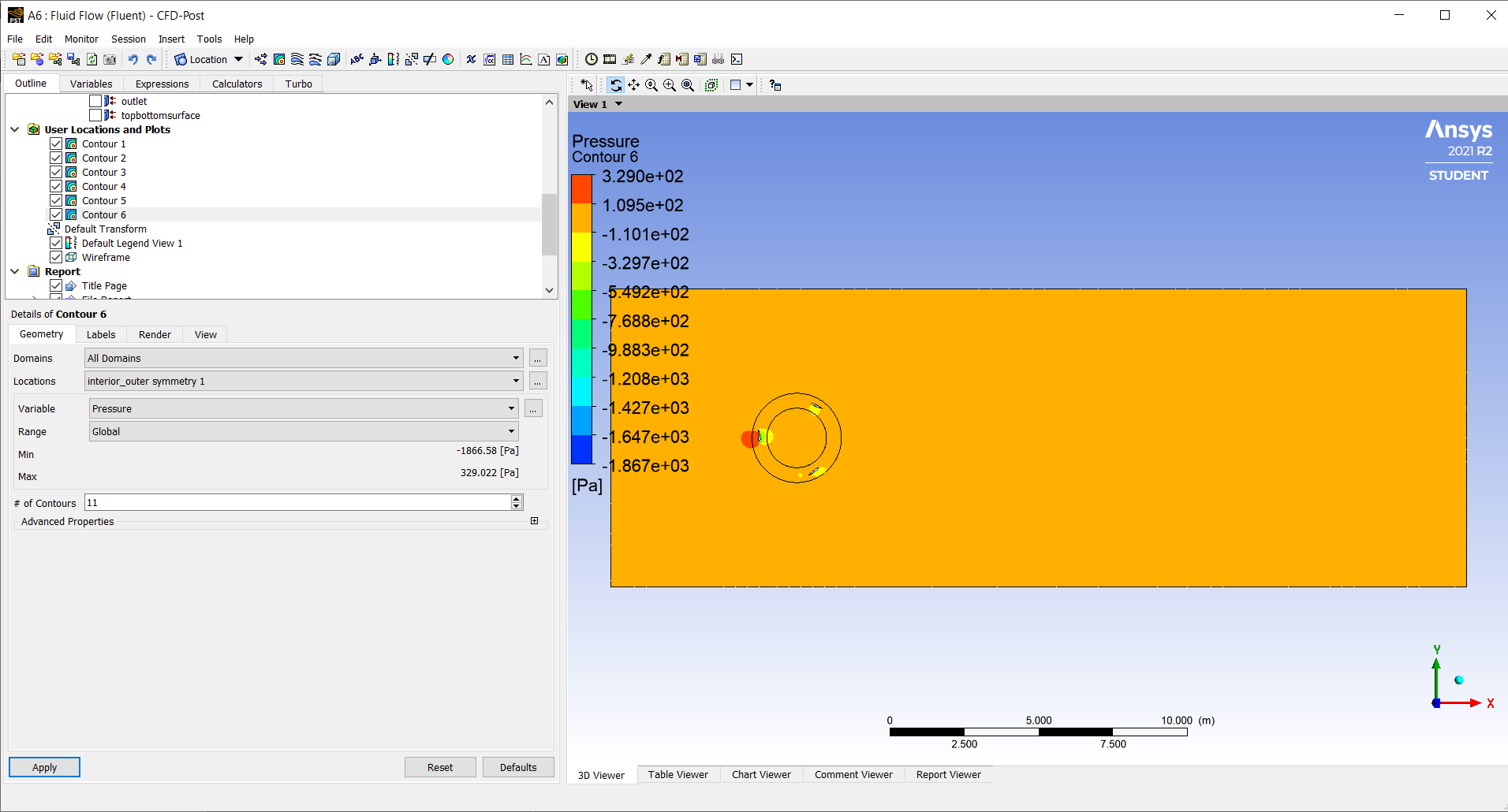

      Pressure contour:
      Post process in Fluent and zoom in on the areas of interest. Looking at the image you have a local acceleration around the object: is the domain large enough to avoid channelling the flow through the VAWT?
